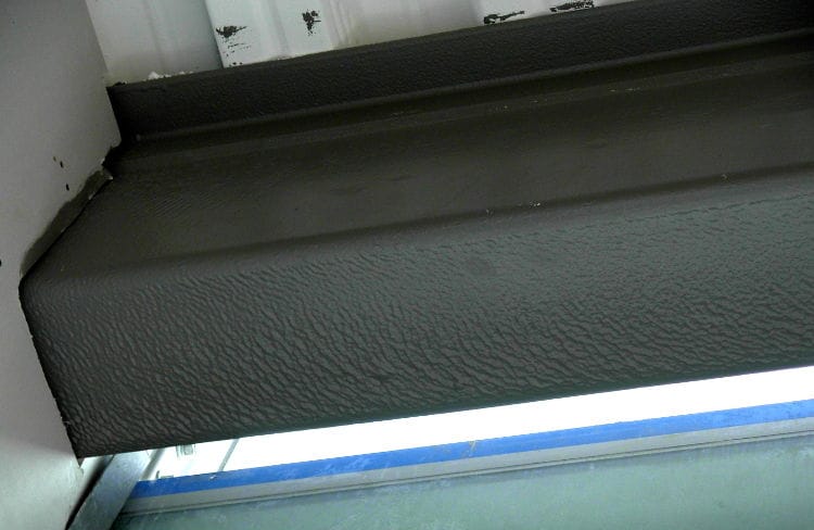

what does it mean to sag? I haven't noticed this before in our projects. You mean it hangs off the steel, or it has uneven thickness and pools in the center of beams? I'm very curious what I've missed right in front of me.
Aug 29, 19 11:21 am ·
yeah, i don't get this comment. i imagine that in a controlled and properly applied, this product won't "sag".
That's exactly what I mean by sag. In my limited experience it tends to occur when using solvent based 'thick' products where you have to apply multiple layers to get a higher fire rating (90 min plus). The paint itself is heavy and thick, combined with a high viscosity and it sags to some degree regardless of conditions and application. Never had an issue with the 'thin' products.
Aug 29, 19 12:53 pm ·
That looks like shit. If I recall higher rated assemblies need to be applied over a long period of time, and one reason to do it in a factory controlled setting. Plus, I mean, gravity?
The sagging is usually an issue of applying a coat too thick. I think this is mainly an issue with the one-component formulations (water- or solvent-based). The outermost portion of the coat dries faster than the underlying portion and the skin that develops can look wrinkled or sagged when the underlying portion that is still liquid moves because ... well, gravity as b3ta puts it.
Thinner coats are able to dry more evenly and sagging shouldn't be as much of an issue. But thinner coats means more coats (more labor, more money, more time) because these coatings need to build up a certain DFT over the steel in order to protect it from fire. I've been told that you can sand the surface of the coating down to get rid of the sagging, but you can only get so far with this, it requires adding/buying extra material so you can sand away some of it, and more labor/money/time.
Is this what you mean by sagging? (source)

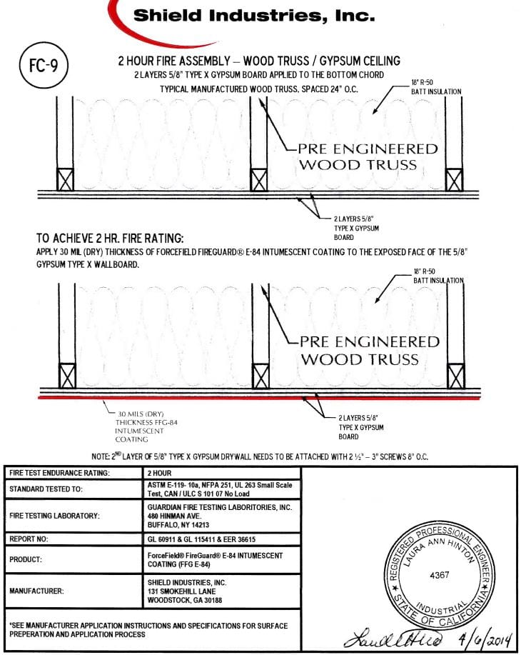

have a question for anyone out there familiar with intumescent painting process. Does anybody know a ballpark number for what labor per man-hour should be charged, or the cost per square foot to apply the coating. This is for a 3000 square foot ceiling with Type X fire-rated drywall, it needs to be at 30 mils dry, applying force field e-84 intumescent paint. Also any tips on applying this particular product? Thank you.
You're applying int-paint to a gypsum board surface? Never heard of that before. Got a UL design no. to share?
The Engineering Judgement is in the mail!
https://shieldindustries.com/fireguard_wp/fireguard/fireguard-e-84/
The Floor/Ceiling assembly data sheets are presented as remediation to existing construction (i.e. before/after).
The FC9 assembly w/ engineered wood joists and a gyp soffit does seem to offer a "UL 263 Small Scale Test" designation.
I don't think the presentation on the data sheets precludes using it in a non-remediation application (i.e. new construction). UL 263 is just a test comparable to ASTM E119. The IBC allows both for determining fire-resistance ratings of building elements.
I haven't dug deep into it, but it does seem like a code-acceptable method of achieving an hourly rating in the assemblies shown on their website.

This looks to be in the realm of what OP was referencing, based on a loose interpretation of commercial below, residential above:

Isnt there an issue with Int. Paint sagging? I would be worried about the application process of a ceiling.
^That was my point. The finish never looks good.
You can always spend the money on factory applied intumescent if it's that critical, but all of the applications I've seen on high profile projects seem to be satisfactory. Perhaps better prep and people that actually know how to spray will help.
FWIW, 30 mils DFT isn't that bad for an intumescent. It could be done in two coats of the product in question. Three if you were concerned about the finish sagging. You could also roll it on per the data sheet ... although at a thinner WFT per coat so it would take more overall labor to achieve the same 30 mils DFT.
I'd like to jump in on this thread and note that there is a UL listed design for the use of intumescent paint over 5/8" Type X Gyp to achieve a 2 hour rated wall. I work with the manufacturer and we are in process of listing a 2 hour gyp ceiling and 1 hr wood ceiling with UL as well. The current UL wall listing is BXUV.W310 (or find it under ICC ESL-1191). This is the ONLY UL listed design on the market at the moment. Just FYI.
