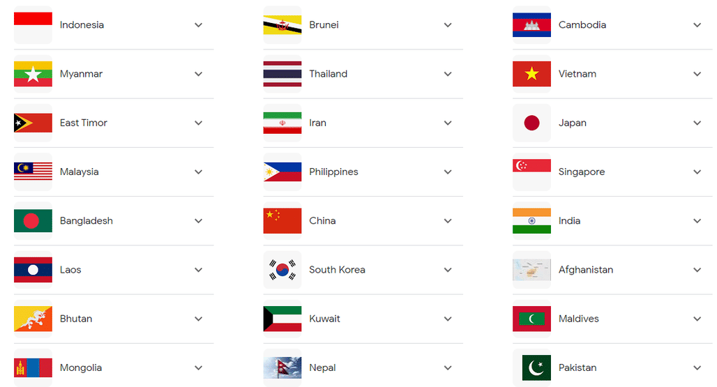

It could just be ignorance Will.
Also Korea is considered to be included in the general descriptive term of Asian.  Then again, so are:
Feb 11, 24 6:16 pm  ·
yes. exactly.
Feb 11, 24 8:41 pm  ·
Asian = Korean and vice versa.
Feb 12, 24 4:38 pm  ·
I hear Americans use Asian to mean Chinese/Japanese/Korean. Brits use it to mean India/Pakistan. I'll admit to being sensitive because of my personal background. Setting my hangups aside, the best way to find the OP's answer is to focus on which bit of Asia the example is from. Because its a huge geographical region with lots of variation.
Feb 12, 24 5:13 pm  ·
I agree! It's like saying American style when you're referring to Prairie Style. Realistically though, it's because the OP is ignorant.
