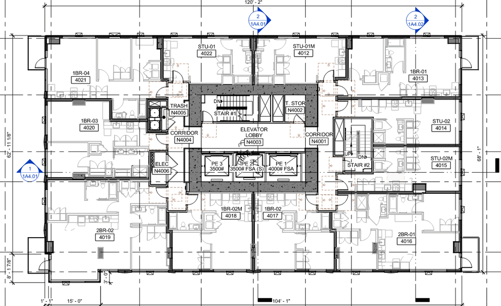

As an example for high-rise residential buildings, Seattle House, a 440-foot two-tower condominium project currently under construction in downtown Seattle on which I was both Managing Principal and did a lot of design and planning work, is highly restricted in the plate sizes of each tower due to Seattle tower spacing requirements from the zoning code (another project was permitted across the alley before it, though it's not built yet). Each of the two towers has a floor plate size of around 7,000 sq. ft. (which is very small for a Seattle condo tower).
Each tower needs two stairways, with required separation distance between the exit access doors. Structural core requirements for a 44-story building also take a big bite out of the plan. Even with a fairly efficient and compact plan, the second stair reduced net rentable area per floor by 3.3%. Now, that may not seem like a lot, but in this building that resulted in a loss of around 21,000 sq. ft. total, or three entire floors of one tower. Where if we had been able to do scissor stairs, we could have built 28 more units at only minor additional cost.
You'll get no argument from me on this. I totally understand. In the medical and education sectors, small increases to circulation can severely reduce exam room / classroom area.
Before anyone say so - simply moving a stair to an outside wall / corner doesn't solve this issue and often creates other issues.

Seattle House, like most residential towers in Seattle, uses a window wall system rather than a curtain wall. It's a fair bit cheaper, and a whole lot easier to install with residential tower sequencing.
