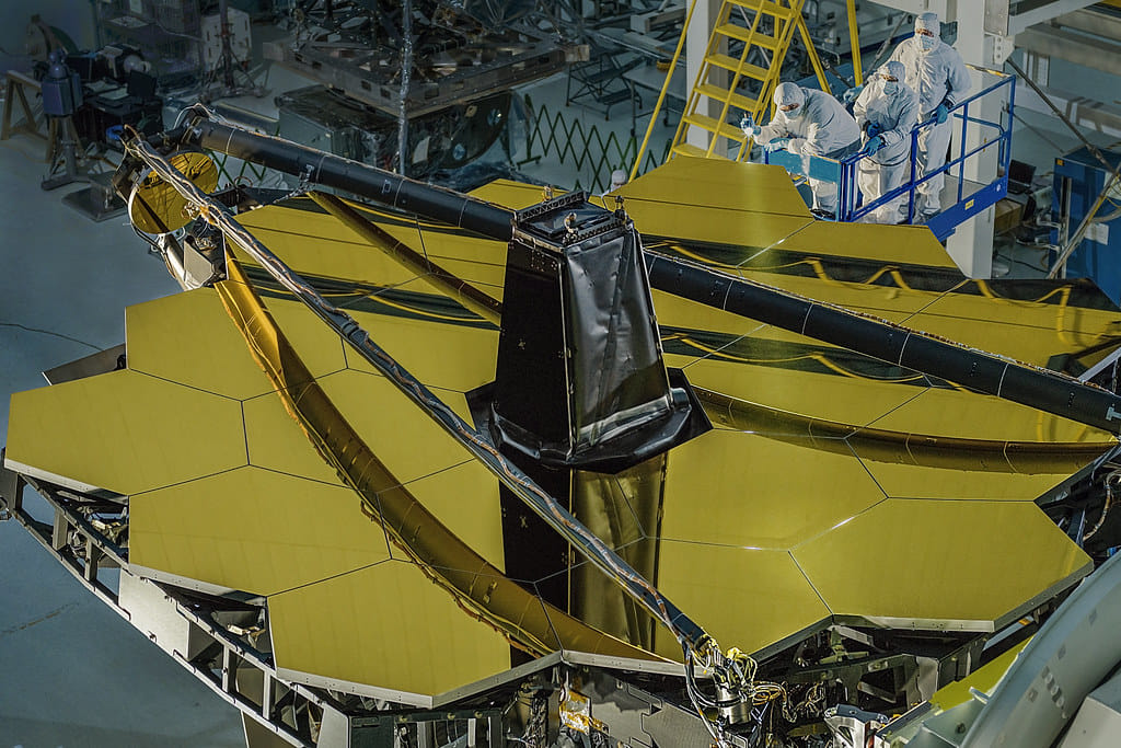

NASA likes hexagons:
https://www.jwst.nasa.gov/cont...
