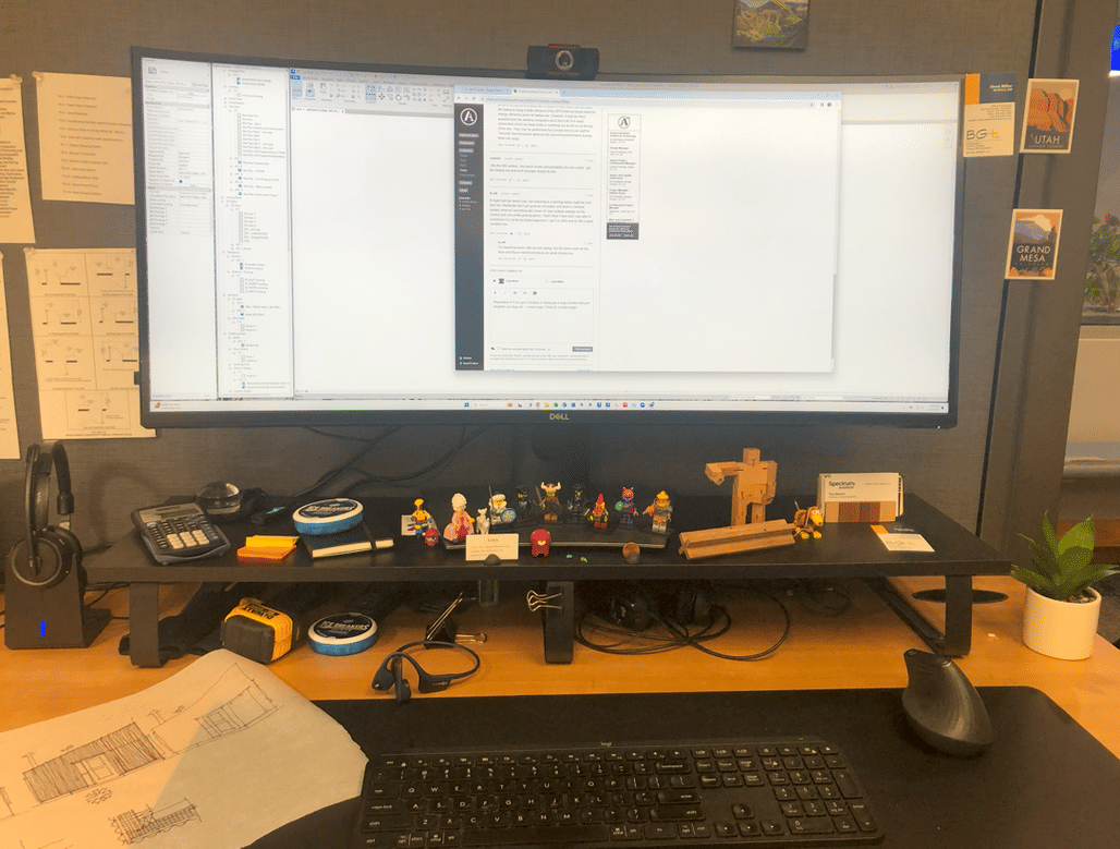

I don't know about screen size. The monitor in my image is 38" and slightly curved. I sit 20" away from the monitor and don't have any issues. If I want I cant get a few inches from the screen and don't have any loss of resolution.
That's probably why the monitors cost around $1,500 each. :s

I don't know about screen size. The monitor in my image is 38" and slightly curved. I sit 20" away from the monitor and don't have any issues. If I want I cant get a few inches from the screen and don't have any loss of resolution. That's probably why the monitors cost around $1,500 each. :s
