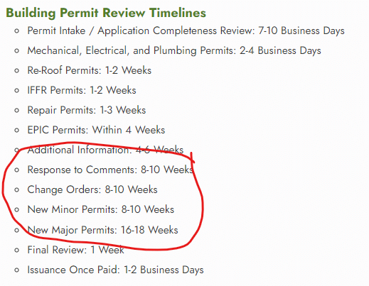

Yes. The published timelines from municipalities are usually 100% fictional and should not be taken at face value. But as I said, a significant reason for that is very poor quality submittals by applicants. If you tighten up your submittal game and really get it dialed in to what the municipality needs/wants, you can then start to get close to those published numbers, and sometimes do even better.
