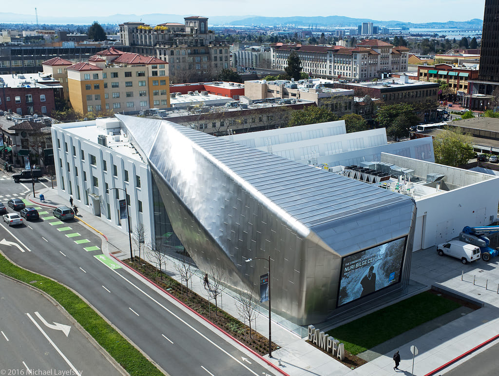

way too much oilcanning going on in the third image of the original post. way too much oilcanning in the world in general - architects oughta learn more about sheet metal fabrication and assembly process to avoid this epidemic.
A few suggestions: spec thicker gauge stainless sheet if possible; panelize into units of appropriate dimensions for the application (no, you can't build that mirror-finish seamless 30'x100' facade from the render), keeping in mind transportation, installation, and thermal expansion/contraction throughout projected lifetime - also stiffen your panels! Braking sheet metal into pans (give em 90 degree bends around the perimeter) is a good start, cross-braking diagonals (think typical galvanized hvac panel) is even better, but more pronounced aesthetically. For my money, I'd rather have diagonal lines across the panel face than uncontrolled oilcanning everywhere... There's a few other ways to achieve a lasting flat appearance, but these are the easiest choices that seem to be routinely overlooked by designers. There's maybe two projects that I've ever seen where oilcanning seemed to actually be a desired and calculated aesthetic - unfortunately I can't recall immediately where and by whom...

Denver Art Museum is supposedly supposed to have the oilcan er I mean handcrafted look.
was the Guggenheim Bilbao? I mean it's some sort of a feat to make a multi-milion dollar titanium facade look like so much crumpled up tinfoil, but I'd spend my money elsewhere
I believe so. And I agree.
