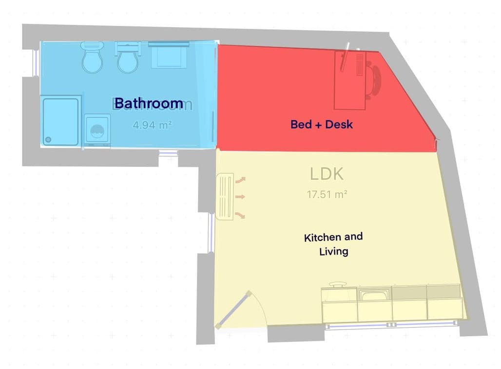

Those colours don't really go well together. Maybe try keeping them all to one colour but use different shades to differentiate the areas? That probably will help.

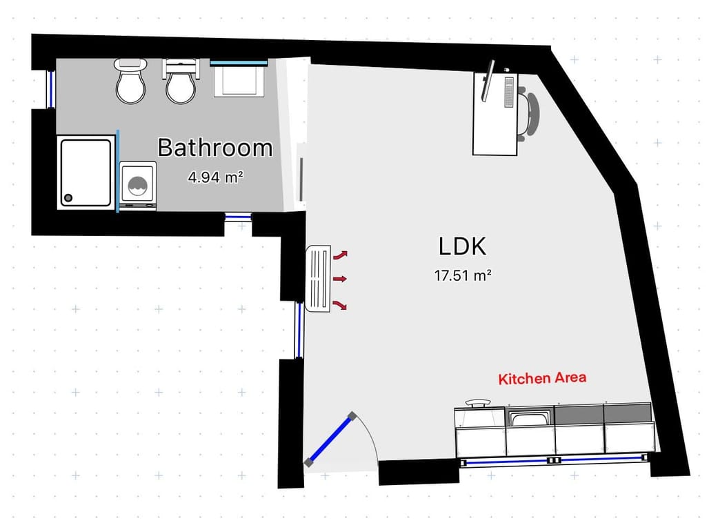

I do... as pretty much the rest of the non-usa world. Also, there is clearly a bidet in this tiny studio shoebox. This is clearly from a more sophisticated country.
I noted the bidet as well. Wondering if you can spy the front door while cleaning your nether regions though. Not sure if the sightline is really there.

EA, the sight lines are pretty bad but it all depends on how much you warp the space time continuum.
I spot a small "dead cat space" in the kitchen and living area, and the desk chair looks like it won't hold a human working at the desk without needing to warp the space time continuum to exist in the same space time as the wall ... but other than that, what are your concerns?
This is the kind of space you'll need to develop some kind of creative custom furniture solutions for. It simply doesn't work with conventional desks/beds/etc. Is that supposed to be some concrete building with a "modern" form? Those work so well don't they....
Also LDK?.....that is clearly a 1K that someone wants higher rent for. 値打ちこいてる
A floorplan design that is not working..
Do you guys have any suggestion on this small studio floorplan, that is not really working?

Is this for a school project?
upper cabinets in front of windows
Bathroom seems very large
No closets
Not sure there is room for a bed
I agree that the bathroom seems large. Idk about metric countries, but in imperial countries, we like light and air in our bedrooms.
