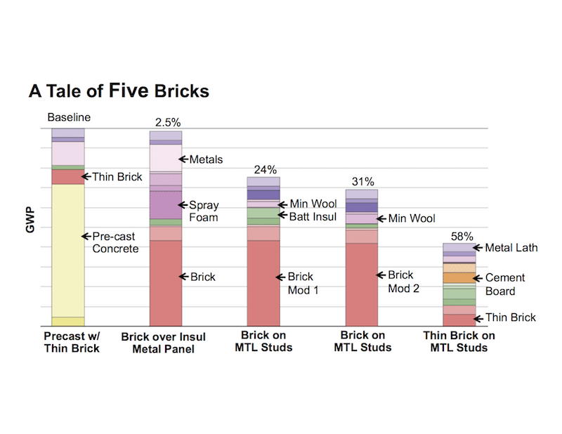

Additionally, I've seen situations where the material choices are baked in because of design sensibilities even if they wouldn't really change the look and feel. Here's a perfect example of a typical stud backup wall with brick being able to save some embodied carbon by changing to thin brick (The usual around here would be the middle option changing to the thin brick on metal studs which could be something like a 30% reduction). I've suggested this to teams before and it's like I asked them to sacrifice their first born to the sustainability gods.
I even got the response once that they wouldn't be able to get their regional materials credit for LEED if they changed to thin brick because they wouldn't have enough percentage of the project cost tied up in local brick. The specs can easily contain the requirement for local material, but they can't make the design use a different assembly if the design isn't changed. This is why I push back on the specs being the place where sustainability is made to happen.
P.s. the source of the infographic for the bricks is from this Building Green article: https://www.buildinggreen.com/...
