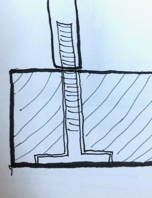

Ellaine, am I correct to understand your question as: you’ve got threads (from a bolt or embed) in the ceiling poking down, and you know you’ll have threads from the wooden step poking up, so how to fit the tube perfectly between ceiling and wood tread?
Let’s tackle one end at a time. If you don’t have the threads poking up from the wood step, you could reasonably fit full length tube over the threads from the ceiling, yes? Provided you don't have very short distances. So the real problem is the connection at the step.
The example in the link you provided gave away the answer. Did you notice the cover / round plates at the bottom of the steps? That’s likely a countersunk cover for the treat going through the step. If threads go through the step, then the tubes above can be the full length, and the tread will thread into the tube from the below through the step. And if this plate is connected (welded to) the thread, it’ll provide bearing on the step. Is this the structural function you are looking for?
