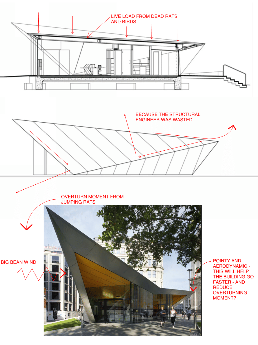

Chad, a great set of diagrams. What killed the rats and birds? If it's poison then that should be included in the loading, or are they just in awe at the building and get stuck there looking at it?

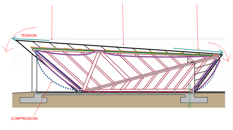

First, it is not a regular roof type. It's a custom roof design that involves concepts from various roof types. This is why trying to decide what roof type is going to be a fruitless effort because it isn't a "type" of roof. "Type" implies that the roof design is used on multiple buildings establishing a typology. This is custom designed and engineered and probably involves principles from multiple roof types.
So the above drawing is what I've done based on the drawings online. Is the yellow arrow where the holding down bold goes? Also, is the red arrow where the foundation is? Thanks

I'm not asking if the foundation goes above or beneath the building, but it in that diagram, is that the foundation because there is a gap between the building and the foundation. furthermore, it looks different from the engineers diagram of the foundation but I also wanted to know if where I put the yellow arrow, is where the holding down bolt would go.
Apr 12, 21 11:44 am ·
It's hard to say on the first diagram what is actual foundation, since it's not a typical type of construction. They should start you off with relatively conventional buildings to learn the basics, not something as unusual as this. Or if this building was your choice, you should start with something that looks more like a normal building, until you understand the various parts and pieces and how they relate. But to answer your question, my GUESS is that the mauve-colored area is the foundation, and in that case, yes the hold-downs would go roughly where your yellow arrow is.

You can see cast-in anchor bolts and leveling shims in multiple construction photos from the MAKE architects site. This matches what's shown in the engineering detail with the concrete knee wall on a spread footing.
There is also a horizontal post-install anchor bolt, likely because the crank in pre-fab frame causes reactions to act at an angle.

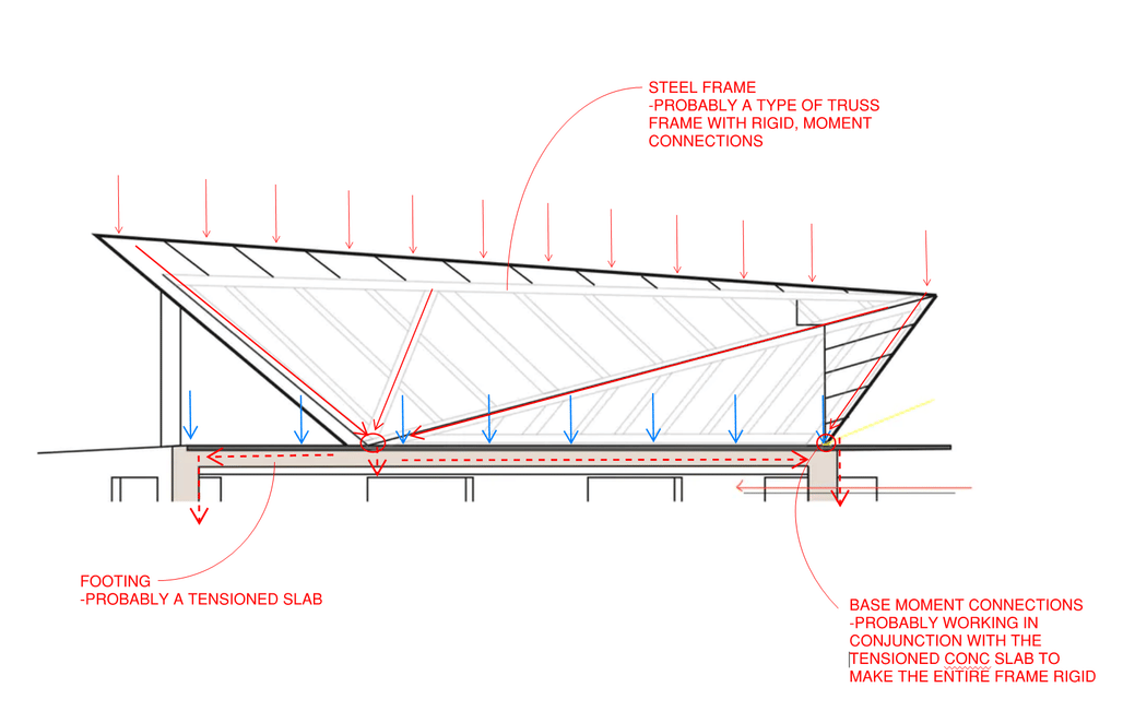

thanks, I'll draw them onto the diagrams and show you what I've done. thanks

Whatever structural theory or construction class this is for, the footing detail and plan posted upstream are from the structural set (not in public domain) which is likely being used with permission for this class. If OP has access to the complete CDs there's a lot of info that can be extracted without as much guesswork. I don't think we're getting the full picture.

Thanks, I've just read it. Is it right to have the settlement loads acting in both directions? is there anything I need to add to the first?
Furthermore, can you help me with the second? I'm not sure how the forces act on the front beam. It's wide and stretches across.

I'm not entirely sure how to show the settlement loads; I only design houses and it's not something we worry about. I think they would be green arrows down at the perimeter and up at the center of the structure. On the first drawing you are missing live loads at the first floor/ground level: people walking around. And you're missing both dead loads and live loads at the roof and ground floor. They should look just like your orange arrows pointing down. Those arrows can be smaller. "Ground pressure" (not an official term, IMO) should push up against the footings (big arrows), up against the first floor (smaller arrows) and horizontally at the footings.

When calculating loads to footings and grade beams, you need to calculate in total loads (a sum of loads) and the area under the load may need to be spread over a larger area in order to not exceed soil bearing capacity in terms of weight units per square area. Sometimes you may need to go to deep foundation systems. I don't know the answer to this nor want to calculate the load for F-Z-J. It's already a headache.
While the top beams will bend and experience some compression the the load will be handled in tension (green arrows) until it is transferred to the angled columns. At the columns the forces will be handled in compression (dashed blue)

a coloured 3D model would be much easier than a simplified elevation drawing.
What "they" expect is a thorough investigation and intelligent answer. multiple views of even a sketchup model (prob less than 1hr's worth of work) will make a big difference. If that's too much, use standard arrows to indicate compression and tension members. It'll be easier than muddy colours.
also, I'm unsure how the load will act across that front beam. thanks

Do they show where these section cuts are taken? Usually free body diagrams like this are in a single plane, but I think we are looking at a three-dimensional structure? I saw the images in your first post but it's not clear to me how these sections relate. There are different ways you could show the load in or on the "front beam," assuming you mean the beam across the top of the image. If the assignment is to show the loads acting ON the structure, you shouldn't have to show how the loads are transferred through the structure. But if you want to do both, if the only columns under that beam are at the ends, then the top of the beam will be in compression, the bottom will be in tension, and the reaction loads at the ends will be upward to counteract the loads pushing down on the beam.

yeah, it's a section of the building but I've included the entire steal shell structure.

Depends if you consider the rats in the walls live load or dead load.
Don't forget the cats that are there to hunt the rats.
Cats are definitely live load, but rats, despite being technically alive, could be considered part of the structure...
But are they gravity loads or lateral loads? Or both? Gotta free body diagram that shit.
See my diagram below . . .
snow 85 psf - wind 115 mph ( 3 second gusts)
Here you go.
Maybe suggest a spoiler to keep things grounded?
Naw, the rats, cats, and birds will keep things stuck down good.

I'll upload what I think is right maybe tomorrow and if you can help, I'd appreciate it.
It's ok if you're wrong. It's important to get used to being wrong. But it's important to try. Yes, we'll review and critique. Almost certainly with some snark because it's the internet and most of us learned this stuff in the dark ages.
That's a great idea. You should of started with that.
hold down *bolt
And architects wonder why those of us who learned how to design and build things on our own don't have a high opinion of architectural education...
If you are drawing this type of building and don't know WHERE THE FOUNDATION GOES then I'm afraid no internet forum is going to be able to help you. Personally I like putting the foundation on the roof, and I connect the hold-down bolt to the front door so it doesn't blow away.
I apologize for the snark, but I thought you were going to show us where you thought the external loads were that act on the (or any) structure, and possibly the reaction loads that you actually design for.
ok, well I am a first year student and we are learning entirely online and they've not taught us much detail about the foundations - not much detail about anything tbh. I'm not asking if the foundation goes above or beneath the building, but it in that diagram, is that the foundation because there is a gap between the building and the foundation. furthermore, it looks different from the engineers diagram of the foundation but I also wanted to know if where I put the yellow arrow, is where the holding down bolt would go.
they chose the building.
ok, that makes sense! Thanks!!!!

Hi, have you seen my attempt below? Thanks
Dead load is dead bodies, live load is live bodies. But as to which goes in the attic and which go in the crawlspace, you have to consult your local building codes.
I hear the guy the main building was commissioned for went from a dead load to a live load. They say he was a carpenter, but must be an engineer with funny maths like that.
I'm not sure how the loads will travel through the beam, connecting the structure?

You must have a roof top patio with all that Live Load going on up there
Thanks, I've just read it. Is it right to have the settlement loads acting in both directions? is there anything I need to add to the first? Furthermore, can you help me with the second? I'm not sure how the forces act on the front beam. It's wide and stretches across.
here, blue is tension, green is compression and the purple is deflection
blue would be compression, green tension
I've done it the wrong way? would the centre beam thats travelling right to left, top to bottom also be compression?

I'm not sure if that's any closer?
For the top one, is it right that the settlement load acts in both directions?
Also, are my marking for blue compression and green tension correct, and the deflection be acting in those directions? thanks

I've made the back of the structure lighter, and the front beams darker, so I think it's easier to see what is going on. is either of the diagrams I've done right?
