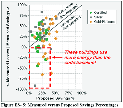

It's an old chart from an old study, but it's such a classic that I can't not share it ...

I have a feeling this chart would not be the same for Canadian Buildings. Especially the ones I was on the consulting team for here in Northern Alberta. Its darka and cold in the winter and probably doesnt matter how white you make your portland cement, and everything has to be trucked in from far away.
