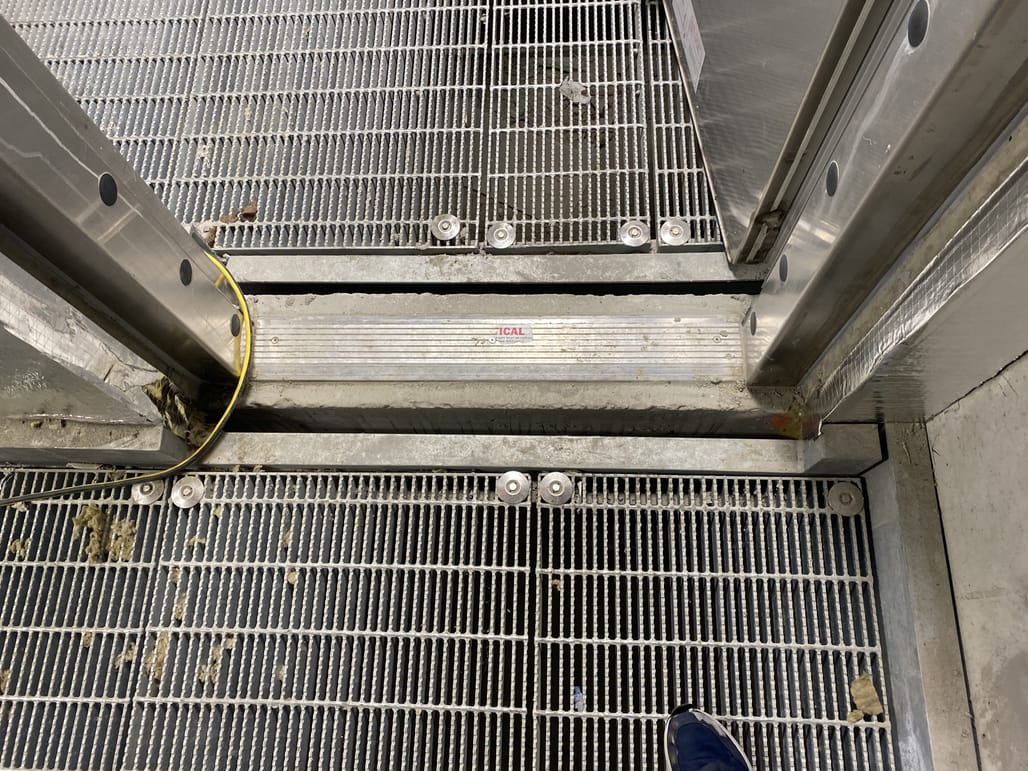

A contractor installed a stair with landing in such a way that there is a 2" gap between the landing and the wall in which there is a door that swings onto the landing. The space/building is EXEMPT from all accessibility requirements. I am looking to cite this condition as an issue in my field report to the contractor, but I can't find a code section that limits gaps in means of egress that are EXEMPT from accessibility requirements.

2014 NYC BC 1009.6.1 Exception 2: In Group F, H, and S occupancies, other than areas of parking structures accessible to the public, openings in treads and landings shall not be prohibited provided a sphere with a diameter of 1 1/8” cannot pass through the opening.
The walking surface of treads and landings of a stairway shall not be sloped steeper than one unit vertical in 48 units horizontal (2-percent slope) in any direction. Stairway treads and landings shall have a solid surface. Finish floor surfaces shall be securely attached.
Exceptions:
1. Openings in stair walking surfaces shall be a size that does not permit the passage of 1/2-inch-diameter (12.7 mm) sphere. Elongated opening shall be placed so that the long dimension is perpendicular to the direction of travel. 2. In Group F, H and S occupancies, other than areas of parking structures accessible to the public, openings in treads and landings shall not be prohibited provided a sphere with a diameter of 1 1/8 inches (29 mm) cannot pass through the opening.

Found it: 2014 NYC BC 1009.6.1 (Exception 2)
What's it say?
1009.6.1 Stairway Walking Surface
Exceptions:

My client, a state agency, doesn't want to accept any code deficiencies it is notified about in writing.
flip side, if the client agrees to keep the gap as is... get to contractor to issue a credit equal to their cost to demolish the sup-bar work.
All the client has to do is to put a wider threshold to solve the problem...

Guys- see my response. No one is replacing anything. All they have to do is put in a wider threshold...
