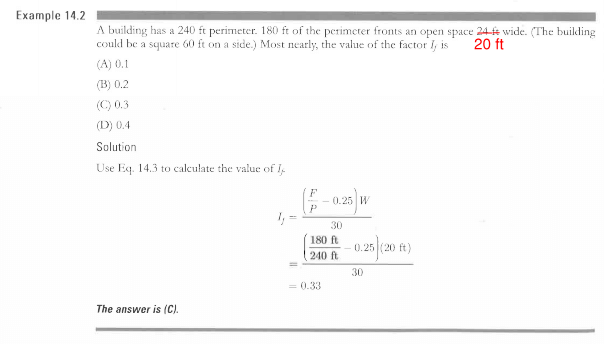

Why doesn't W=24 in this ARE question example?
Check the errata
the answer is 42. trick question

Thank you! I thought it was some type of trick question. Your reply is much appreciated.
