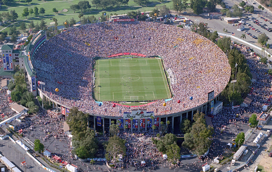

not entirely underground, but pretty close
building into the land/mountain side was the original way to do it.
just put a top on it.
