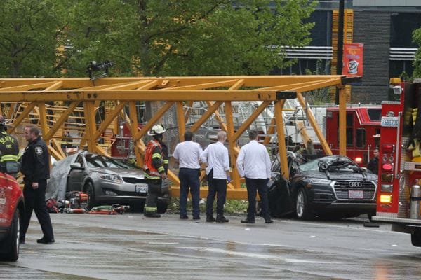

The crane was being disassembled. Normal procedure is to remove large (about 2 1/2" in diameter) pins on the top section that hold the ends of the four crane legs firmly into slots on the identical section below it, while a smaller portable crane provides upward tension to enable the pins to be removed and secures the section. The top section being removed is always firmly attached to the smaller crane which lowers it to the ground after pin removal. After the topmost section is removed the portable crane is reattached and the next section has the pins removed on that section in the same manner. In the Seattle accident ALL THE PINS ON EVERY OTHER SECTION were removed at once so that only the weight of the sections with end tabs of the legs in the slots of the section below were holding the sections in place. Add in an unusually strong wind and the crane blew over. There were several crane companies involved and nobody spoke up.
Note pins installed on top left, missing on top right

that description is terrible...diagrams would help.

Is there a source for any of this besides that photo and your own conjecture?
