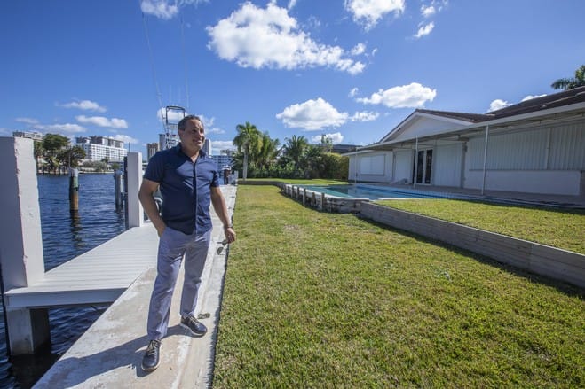

Here is the interior designer dude in front of his family home, which has not been razed yet, on the Intracostal Waterway in Hallandale Beach, FL
the original looks better
