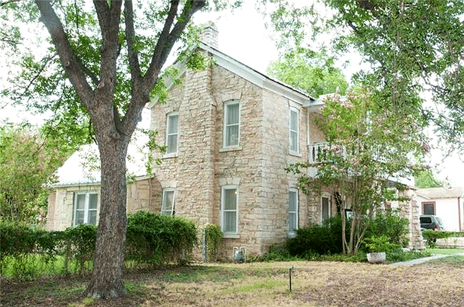

Or, you buy this house with limestone siding, located midway between Dallas and Austin, Texas, for $84,000 US.
Jan 14, 19 6:18 am
Screw those Colorado winters!
Stone siding?
Looks to me like a wood-frame house with 3 or 6 inch thick limestone veneer siding. The projection on the left side of the photo with the larger stones may be a solid limestone wall from an earlier structure.

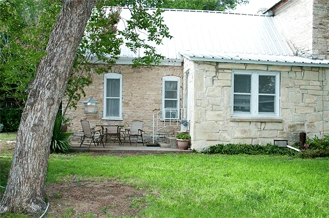

Left side is likely a later budget addition. Look at the cheap eave detail.

Here is a better photo of the left side. The windows and stone size are decidedly different from the rest of the house. Not sure what drove the eave detailing. I think mightyaa should move here and fix this puppy up.

I think you've already got a good idea of what you are looking for. If you are interested I heard of a good local company based in colorado called Conservation Construction. They had better prices than anderson and pella, but i'd have to do some more research.
