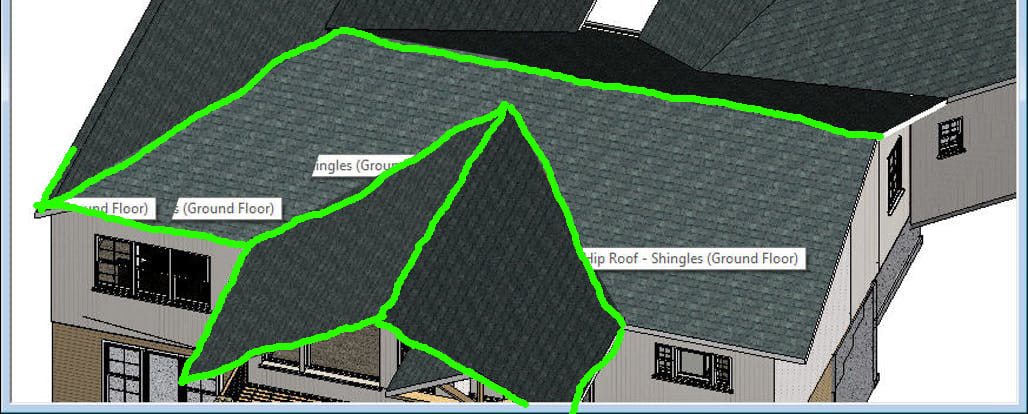

Hey, can anyone point me in the "right" direction to solve this drainage issue?

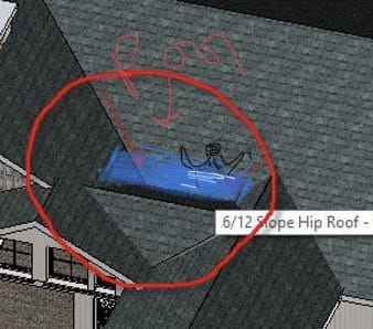

Two points to JLC

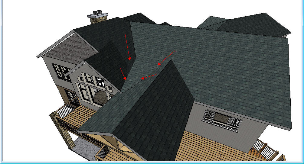

This simplifies things, and adds more covered balcony
Apr 19, 18 10:29 am  ·
Similar idea, less roof
Apr 19, 18 10:43 am  ·

That's a shit design.  You should strongly consider scrapping all those silly valleys and take an intelligent approach to the roofing.
Apr 18, 18 2:38 pm  ·
senjohnblutarsky
A solid redesign is your fix.
As the design stands... no, it can't be fixed.  You can't fix stupid.

Wrong, it is the designer's job to explain what is possible and reasonable within the client's broad scope. Just because the client wants every version of window available at home depot does not mean you have to spend time modeling that option... They will not want to pay your time to show them it's a terrible idea. Also, don't let the software determine things like roof slopes. Work them out before plugging in values in BIM.

Pool

Pool on the roof and indoor waterfall feature - it's a 2-for-1 value add.

Put a some big skylights in that valley to complete the design.

updated with JLC-1 input

might need to use metal roof on that if the slope is too shallow for asphalt shingles....and if you have snow accumulation add heat tape to the valleys.
Apr 19, 18 12:51 pm  ·
Move the whole balcony roof to be in line with the crazy window protruded section of the house.
Apr 19, 18 1:48 pm  ·
I suspect we're not seeing the whole picture for a reason, but you are correct, too many roofs for such a small deck.
Apr 19, 18 1:53 pm  ·
auninja91
theres a cathedral ceiling in the room where the crazy windows are running all the way to the other side of the house...
Apr 19, 18 3:40 pm  ·
auninja91
i had one large gable over deck initially, most likely he will go back to this..fingers crossed
Apr 19, 18 3:41 pm  ·

Even with the change, it's a bad idea.  You should never show a client something that is a problem, because they might decide they want it.
You're dumping a lot of water in one concentrated spot, and that spot isn't even a gutter.  It's more shingles.  And you're running sideways at the shingles; it's not even going downward towards a gutter.  You're putting a lot of trust into the ice and water shield.

frame flat between the two sloped faces and cricket

No reason at all to have that many gables on a house. The idea is to shed rain and snow and not let ice build up. The roof needs enough pitch to shed show readily. You should consider redesigning the whole floor plan to at least do away with the two small gables There are enough simple roofs types (gable, hip, gambrel, and others) to allow whatever statement the owners want without causing them massive problems later on.
