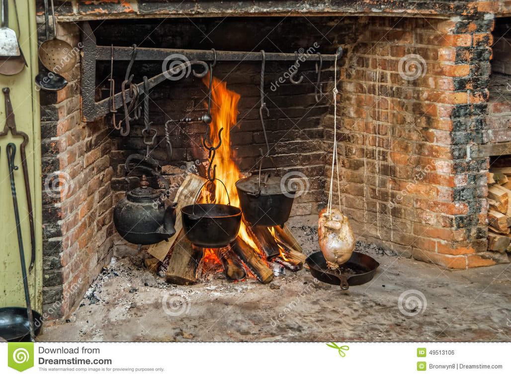

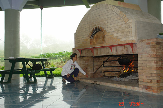

brick oven?
open fireplace....

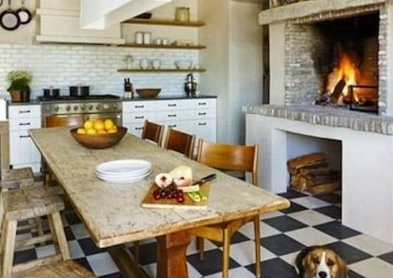

Are you thinking a new build or is this converting an existing fireplace for cooking? A fireplace for real cooking is going to be big
and also may be a different height
sloring,
do some googling...like this;
Google + George = delicious!

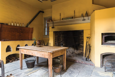

Might look into having a kitchen outbuilding like many of the colonial mansions did. Not only for safety's sake but so you won't bring in heat to the rest of the house in summer.
