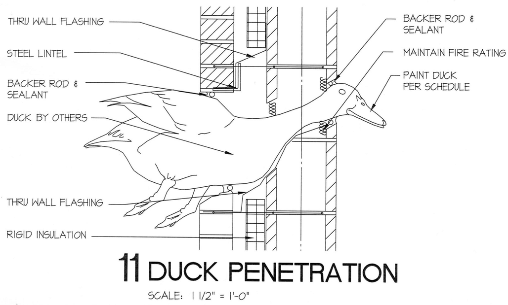

I call the whole set cartoons.
Like this?
No. More like I'll have the cartoons ready by Wednesday.
that's funny ...

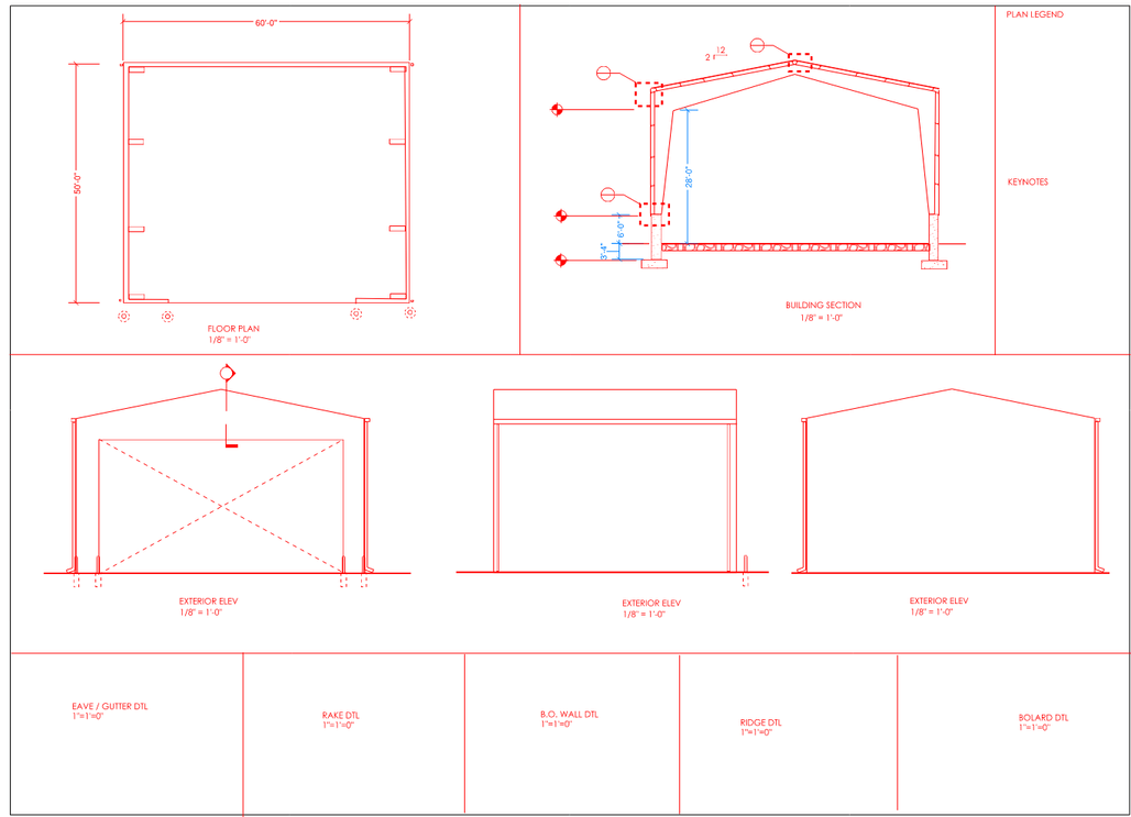

So what exactly is a "cartoon set" to an architectural office or design practitioner? - no one discussed that ...
A cartoon set is a rough plan for the sheets that you want to include in the construction document set, and the drawings, schedules, or other information to show on each sheet.
An example of an extremely simple cartoon set for an extremely simple project.
CDOT salt shed?
Pretty much. An ask by a larger client of ours so we're doing them a favor. Like I said, super simple. Kind of nice to be able to 'turn off' my brain for a project and know exactly the what and how. ;)
Of course, I've now jinxed myself . . . .
Thank you- a story board of sorts ...
Pretty much! On an actual project I'll put more notes about things and assign people to certain drawings.
