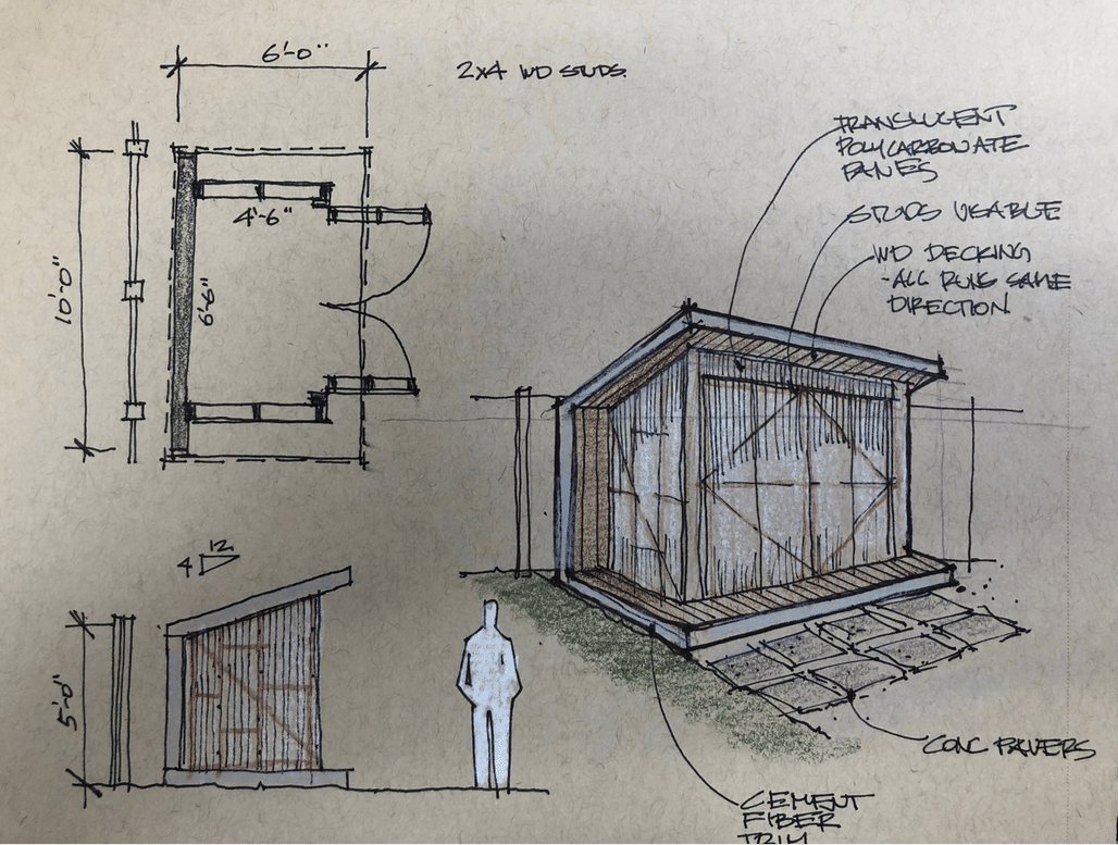

They have worked really well for me. We have some jobs that are coming up on 20 years old and the panels are still in great shape. We usually use Polygal brand panels.
Cool! Thanks for the case study. I'm trying to keep this shed small so I don't disrupt the neighborhood aesthetic. My house on on a corner lot at the 'entrance' to our neighborhood.
The plan is to make the panels removeable. Originally I was going to use untreated corrugated metal panels like what the house has. They patina to a nice burnt sienna / orange. I like the translucent nature of the polycarb though.

Anyone here have experience with polycarbonate panels? I've only ever use the imbedded fiberglass types that don't rely on UV resistant coatings.
The reason for this question is I'm looking at using corrugated ploycarb panels on a shed in my side yard. I know, high Architecture. ;)
Any advice on the material would be appreciated. Crappy doodle of the badly designed shed below.
Tthey're great. If you use the cellular type you will probably want to cap the ends so bugs and dirt don't end up in the cells.

Seriously though. I will be capping the panels. If not, ewwwww.
Thanks for the info!
If you attach the panels with sex bolts or similar you can remove the panels for a once a year thorough cleaning.
