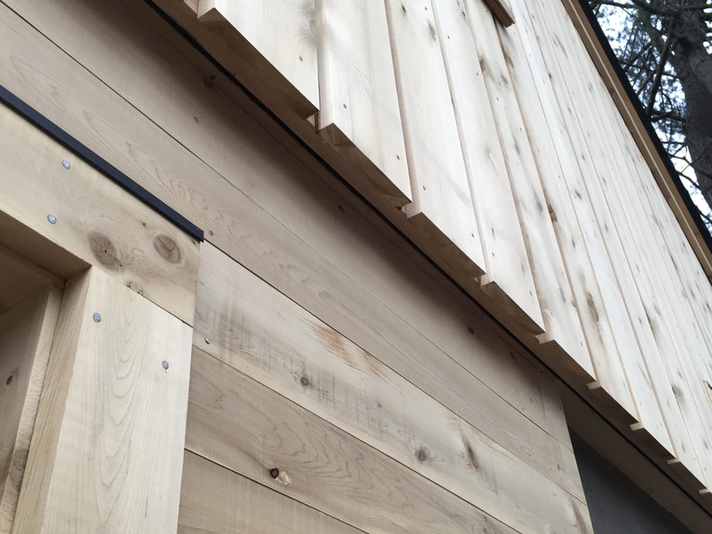

Eastern white cedar, aka arborvitae--the tree of life, locally harvested, sawn and milled. The reverse board-and-batten system provides a built-in rain screen gap. The timber frame elements are eastern hemlock, also a local material. Both have some rot resistance and with good detailing should last a long, long time. This project will be in The Pretty Good House Book, due out in May--it's a Pretty Good Garage!

Do you use cor-a-vent or something similar to let the water drain behind the horizontal battens?

Thanks all! It was a fun project. There are no horizontal battens, just vertical cedar strips over a WRB and the face boards are nailed to that. We used B.Obdyke's Hydrogap under the lower, horizontal boards. Unconditioned storage buildings are much more forgiving than heated, moisture-laden houses in cold climates like mine (zone 6). We did use a ripped strip of Coravent to allow intake air and drainage at the upper section--you can just make out a 1/4" black strip. Again, not what I would do for a house but it worked fine here. The builder actually changed my detail, which would not have been as elegant.

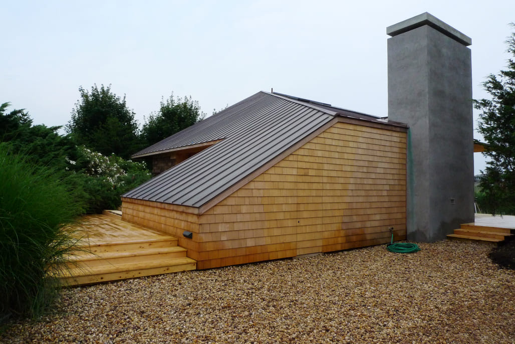

Alaskan cedar shingles and decking, standing seam copper roof, cement stucco chimney. If you look closely there is a hidden door to a storage shed. The copper roof leaves a green patina on the chimney, unexpectedly gorgeous.

Beautiful. Reminds me a bit of Edward Larrabee Barnes' work at Haystack School here in Maine. One of many reasons I prefer natural materials is the character they develop over time. Aged plastic just doesn't have the same effect.

very clean lines
i like the reserved quality of this

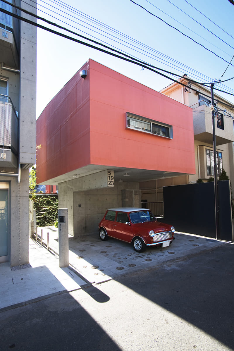

Asphalt roofing used over wood frame on a concrete base. Our first project in Tokyo. Still one of the best projects we have done. The garden space has only become better and the clients remain very good friends.

we went to see the office of atelier bow-wow to work out if there were any issues with using this as a finish and came up with different corner details and added flashing on the top because the finish tends to collect dirt stains at the seams. We eliminated many of those but not all.

Very cool. Did you paint the asphalt or is it available in that color there? I love creative use of tight spaces, and bringing a bit of nature into the city.

the asphalt is painted - with a plasticised waterproofing layer as i recall. There were only a few colors available and we went with this one, I think correctly. The hardest part of construction was to place the asphalt in the very tight spaces between properties. 3 men held the rolls it in place vertically, slowly unrolling it and keeping it level. They did a very good job of it, but I admit it is a much easier job to lay horizontally. We also needed to add a layer of fireproofing beneath the asphalt walls to meet fire-rating requirements, which increased cost more than we thought it would. So the cheap finish ended up being more expensive than we thought. The thing is, because of fire regulations in tokyo the only other options are stucco and cement panels of some kind. In the end I think this was the right material, but we did have to do some research to get it to work...

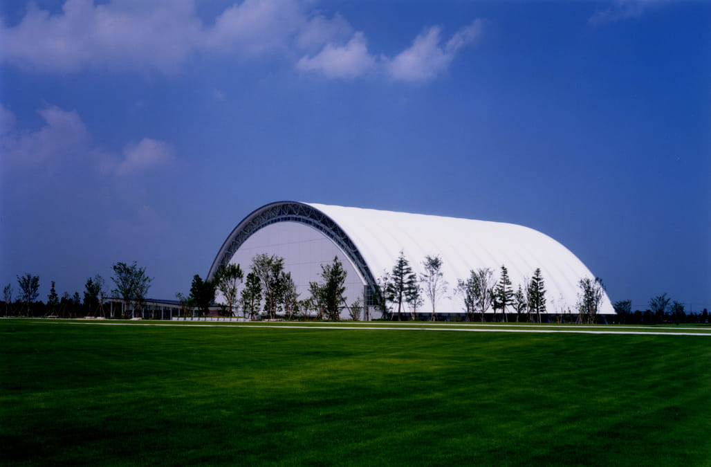

One more....this is the last large project i did for my old office. A covered practice field next to a stadium. It's old by now, done when I was still in my mid 20's which is hard to imagine from where I sit now. It was very fun to work out how to make the fabric roof come together in a simple way. I spent a very long time on the edge details, finally working it out after seeing a stadium by Toyo Ito.

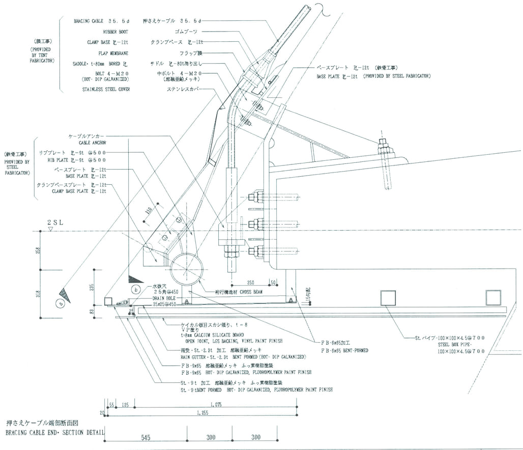

we kind of got it, but a lot heavier in the end, partially because of earthquake calculations, but also because of the heavy stresses that needed to be resolved for the truss and the hold down cables that keep the roof in place. Brilliant learning experience. Not specifically transferable - cuz how many projects like this does a person really do in a career - but the process of turning idea into reality has held up.
Detail of the hold down cables for the roof and the roof edge we came up with.
