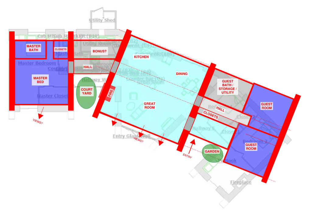

Some tweaks based on the feedback. Momma wanted a courtyard and I like T-duds side access idea for creating one. The over-lit hallways have been removed and I added some small closets. The other bedrooms aren't much closer to the bath but I'm having trouble accomplishing that with my goals. Not satisfied but it definitely seems more functional than the original. I'm working on putting together a list of what my goals are and I'll post that next, I feel like I'm losing sight of what this was supposed to be.
Apr 13, 21 2:17 pm  ·
Oh.... no.
Apr 13, 21 2:25 pm  ·
Why are all the views towards the neighbor's house?
Apr 13, 21 2:26 pm  ·
nothing says good design like placing closets and utility spaces on exterior walls.
Apr 13, 21 2:31 pm  ·
ryanyoung
Ya, I like it even less than the original. The neighbor's house shown is gone now, the land is owned by my godfather who is also planning on a rammed earth/rolled steel retirement home. The slope of the property lets me see over that house as well and there's a great view of small mountains and sunset to the SW.
Apr 13, 21 3:08 pm  ·
If I wasn't on the most boring lunch and learn with no credits associated with it, I never would have done it. I'll probably regret it as-is.
What is this weird kink? Get rid of it. Make the rammed earth walls straight and bring them inside. Overhangs, they are a thing in the desert.
Apr 13, 21 2:37 pm  ·

Solid improvement.
Apr 13, 21 2:38 pm  ·
900% improvement.
Apr 13, 21 2:52 pm  ·

This is actually really close to the very first design I did, the offset parallels at least. I was just looking at it and thinking I should give it another try.
Apr 13, 21 2:58 pm  ·

ryanyoung
Gonna think about this a bit more, read through this massive thread again, stare at previous versions, and try for round 4.
Apr 13, 21 2:56 pm  ·
ryanyoung
Also, utility room has an exterior wall.
Apr 13, 21 4:01 pm  ·
Jay1122
Jeez, some of the tiny things you care about amazes me. You need big concepts before your "Kitchen sink faces out into dining room, Guests pass dishes over, stay engaged while washing" Kind of stuff.
Big ideas man.
 "Water loss mitigation Kitchen, master bath, bathroom, all connected to laundry/utility" What? You want to use gray water for your toilets? On site cistern tanks?
"Roof penetrations (vents etc) covered by higher roof overhang" Huh? You just need proper flashing. Who cares about overhang. I would never let that drive my design.
"N wall continuous to prevent flash flood water buildup Rare but it does happen, water from NW and NE and flow to the W/SW low point". Huh? talking about storm water management? Serious?
You are really stepping into the territory I think is beyond your capability.
Apr 13, 21 5:26 pm  ·
ryanyoung
These all stem from the same thing, inspecting thousands of houses for damages. Water is the most destructive force on the planet and I want to build in a way that reduces the risk of loss. It starts in one of three places: the sky, the ground, or the pipes. Water from above is way more of a hassle to negate than people let on, if I climb a roof for water intrusion then 90% of the time it's the vents or valleys (often due to additions) where the water got in. My solution, no valleys and cover the vents.
Apr 13, 21 6:51 pm  ·
Makes sense, you're hyper aware of a problem and working with a limited set of solutions. This is where an architect would be of value. We also understand this problem, but have a wide range of solutions to work with.
Apr 13, 21 6:58 pm  ·
ryanyoung
That hit the nail on the head. But they're busy and I'm bored.
Apr 13, 21 7:02 pm  ·

Rammed earth walls should have nice deep windows.  You want to experience the wall thickness.  The revise above by arch anonymous is good because of that.
Apr 13, 21 4:17 pm  ·
