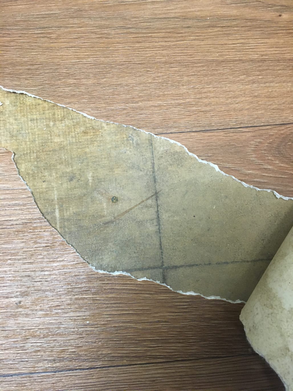

We’ve been painting the kitchen this weekend, and happened to accidentally damage the roll vinyl flooring.
Underneath we find this:
They’re large 12” + boards. The black lines appear to be either print or dirt from a previous flooring job. They are nailed over the floorboards and have a 5mm joint.
I suspect asbestos, however due to their size, I’ve only seen joints and nails, I think they may simply be cement backing boards for tiling.
I don’t want to remove the laminate on top until I’ve tested a sample, so unwilling to pull up more.
yikes!, you have a 50/50 shoot depending on age, looks like fiber cement board/tile, used to be made with asbestos fiber, and the caulk should be tested too.
So, encapsulate it, by placing a layer of cementitious board over existing vinyl, and put new floor over that. Before you do that, screw the existing floor onto the floor joists as often as you can (12" in one direction, 16" in the other - assuming your floor joists are at 16" o/c) through the vinyl that way you don't disturb the asbestos. Then place porcelain tile on top.
Not saying that it is, what I'm suggesting is that we're all encapsulate, but we don't even know what it is. Test it. Decide next steps. Plus, I'm seeing costs in the area of $2-$3k. Not necessarily budget busting.
He doesn't even know if it's asbestos. My point is that encapsulating puts off a problem, that you may not even have, kicking the can down the road when it will cost more. Additionally, how many thresholds exist, two, or three? Adding a min 1/2" at all locations. Cabinet base? Test it, then decide. I just don't like asbestos in my home. There are instructions on the internet to do this yourself.

Thank you for the help. I have spoken to our neighbour across who is renovating - they had the original boards and tiles (same underlay boards as mine) and confirmed that his were asbestos. Boards were visually identical, so I am treating as it is asbestos and will board and tile over with a 6mm cement A1 fire rated backing board.
Has anyone seen boards like this before?
You cannot afford asbestos abatement, trust me.
pay for a test, they're cheap.
Abatement, however, is not. Encapsulate it.
b3ta, the OP's project is to paint their kitchen, not do a full renovation from what I can infer. $2-$3k could literally be 10x their original budget.

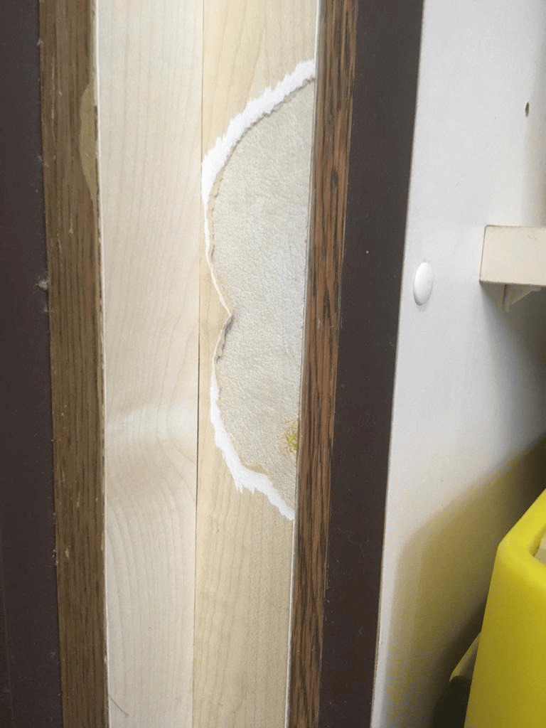

On another note, the laminate has peeled off from a corner unit blank panel. We have the original chocolate brown kitchen carcasses, with white 'PLEATHER' hidden under a 'new' maple melamine veneer on the facias...
