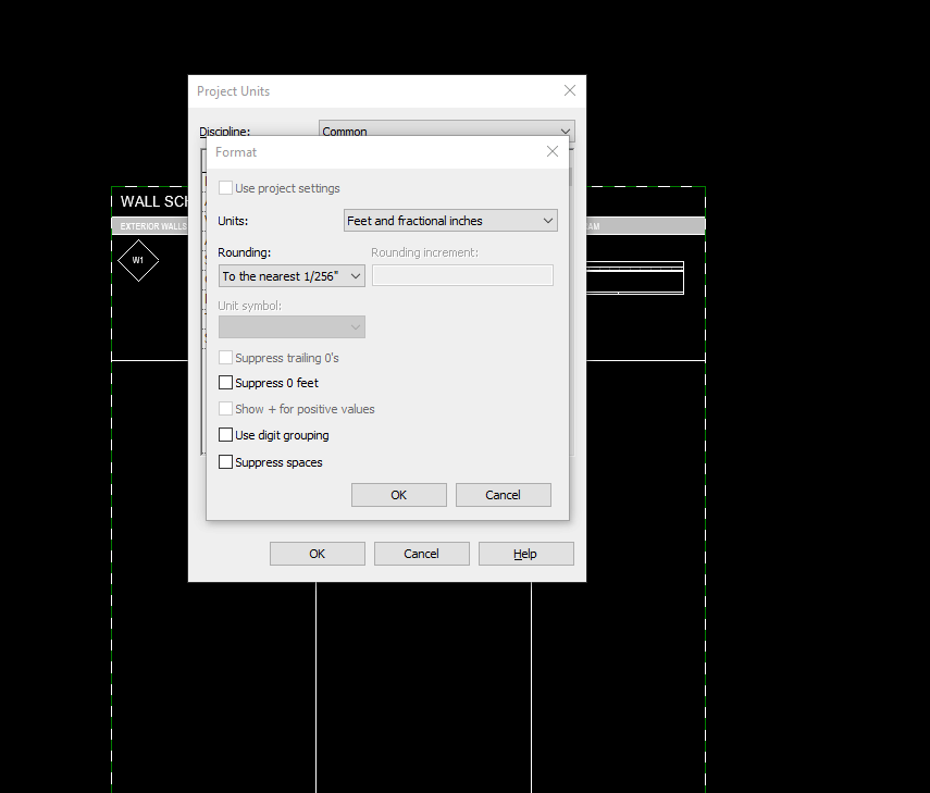

If it's possible to set precision below 1/256" in Revit, I haven't found the setting yet. What I *have* noticed is that when importing DWGs that were set at a low precision, Revit will introduce little /256 errors here and there and my neurotic brain just can't ignore them.

That's precision for dimension rounding. You can still move things into 256ths territory. Also grab the dim string and it'll give you the real dim in the properties palette.

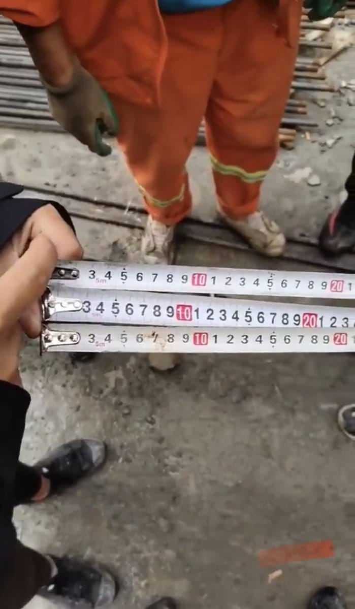

Never mind the door frame - how 'bout the door? Is it 914.4mm or 915mm or 900mm. If you are having brand new doors made, you can have them any size, but if you are buying what's already available, chances are they're 3 feet which is 914.4. One shouldn't dimension doors anyways - set them 100mm away from adjacent wall, and that's it. Codes sometimes contribute to the mess by rounding off stuff to the old Imperial system. Should the guard be at 1070mm height or 1100 or 1050 or 1067...?
Maybe should add to that “Do not scale anything until we approve your tape!”
Dec 11, 20 5:23 pm ·
LOL. Hopefully it's obvious to others that the one in the middle has been re-rivetted, or else the holes would be slotted as usual. But in case it's not obvious...

Can definitely set your precision in revit.

And then you hand over your drawing with the perfectly drawn measurements to the contractor...
“Do not scale drawings”
I thought it was an obvious photoshop.
i thought it was just a VE tape measure
LOL!
One cheap Chinese-made, one American (metric not really their strength), and one Canadian - too much American influence.
Or, they are all orientated differently in the z axis so they don't align.
Also a wide angle lenses and possibly photoshop.
