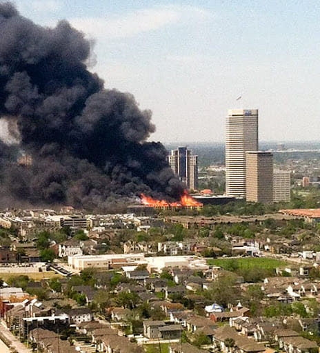

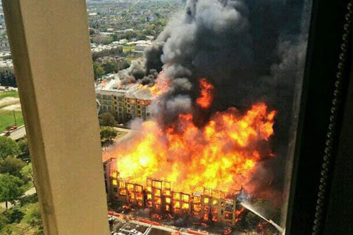

The Texas Doughnut
burn baby burn
apartments are built out of match sticks. this is what insurance is for. don't include language like "set the building on fire" in your specs and you should be fine.
