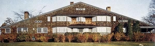

Wiki says the gable is 140 ft long. Draw a 140' rectangle in Rhino, insert the photo, match perspective with camera, draw a triangle perpendicular to the rectangle, and drag the vertex up until you hit the ridge line on the photo.
Printing out the above photo and using my junior high trig, I came up with a 18 degree angle up from horizontal at the ends with a 144 degree included angle (72 degrees * 2) at the top and a pitch of 3.7 to 12. If the gable is 140 feet long the maximum height above the gable line calculates to 21 feet, 8 inches exactly.

William G. Low House
Does anyone know the roof pitch of the William G Low House, Bristol Rhode Island?
not sure, but looks pretty low.

No, but I'm pretty sure you can get a close enough number by scaling the picture... or looking at the elevation drawings.
lazy student is lazy.
Or count shingles.
