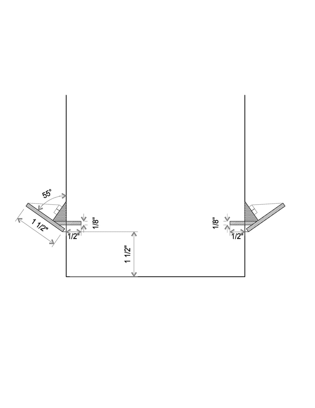

We have done this in the past, which is time consuming and can be botched in many ways; Now I'm looking for a prefab molding or extrusion that is similar in shape and size, so far nothing from major manufacturers, do any of you have a source for something like this?

thanks! this is very similar to what I've seen everywhere, the issue is trying to hide the light source completely from below while having a minimally exposed molding. I usually use these guys, they even got a flexible channel http://gmlighting.net/Bendable...

trying to avoid the kerf into the wood beam, looking for a surface application
I'm not sure where all you've looked, but this is what we've used in the past: https://q-tran.com/product-cat...
I've used this one, the channel looks nice when exposed. https://www.diodeled.com/chromapath-builder-accessory-45.html
One caveat, according to the electrician there's still a kerf necessary, as the clips don't hug the channel to the substrate, there's a minimal gap.
There are many suppliers for indirect LED lighting moulding especially in Europe but I have found this one who offers the most variety.
