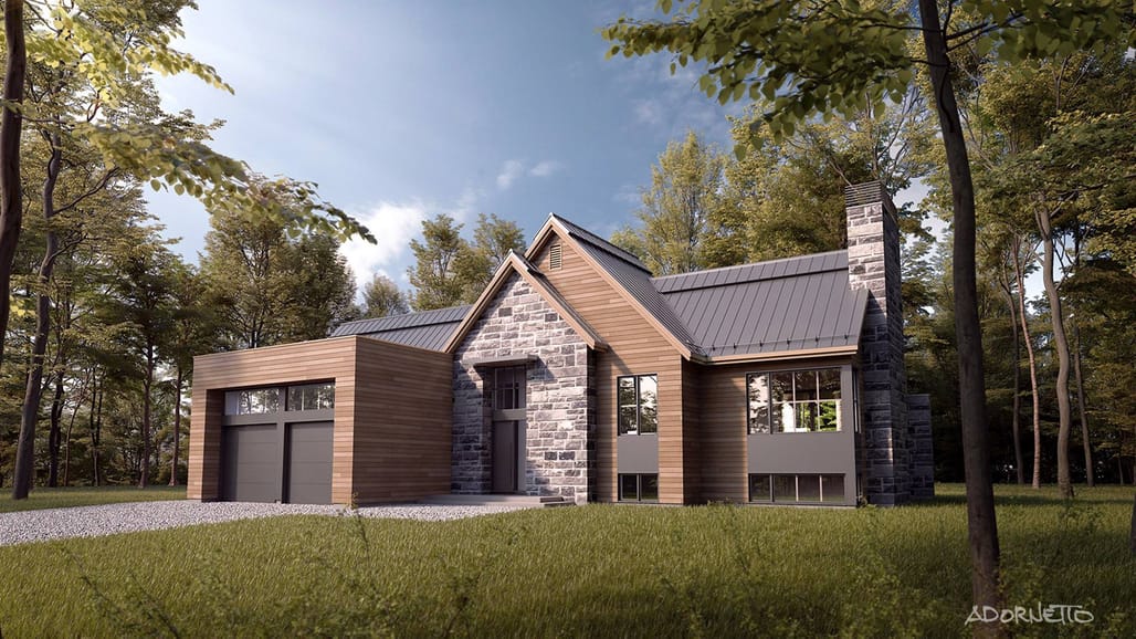

I recently worked on a fantasy house which would be build in a rich area and I came up with this concept in which I try to mix both the emotions of a traditional home with a bit of contemporary addons but most people to who I shared it with, say there is something missing and I am trying to figure out what..so if people could help me I would really love it! Thank you very much!
Dude- fantasy home? lol... I wouldn't want to live in this thing even if you paid me to.

Why so? By fantasy home it means it won't be made... it is a school project I am redoing

You wouldn't live in a home even if they paid you?? Either your rich or something's missing

What's missing are the traditional elements. Instead of trying to mix both traditional and contemporary in one shot, try adding all the traditional elements through historical research and photos then add some contemporary elements and remove anything you don't need.
Google 'transitional homes'. They are often updated 60s and 70s tract homes. What drives the modernists insane is that the results are often modern versions of a style earlier than the tract homes themselves.
That window in the first floor does not cut the wall. Shows masonry behind glass. Also, white vinyl siding? Great idea, certainly will fit right in your “expensive” hood.

It is not vinyl lol it is wood, and the interior has brick walls too thati s the reason

still all are bad ideas.

why so?
Aug 12, 18 11:58 am ·
because dressing up a terrible box with fancy materials still leaves you with a terrible box. Make an effort designing a box that is not terrible to start with.
Besides the obvious boring/genericness of it. The first thing that sticks out is the big gap between the gables. That’s a pit for leaves and other garbage. I can only imagine there are many other such design holes throughout the space...
The weird setback with the institutional railing and awkward shadows only draws further attention to the odd roof line. Almost looks like it’s two attached houses rather than one contiguous thought.

so , working to not have lost space just in order to create different volume? volume should be justified by utility not just for aestethic. and the the shadows you mean at the entrance of in genreal? do you have tips to attach 2 parts of buildings together?
Masonry doesn't typically go up in gables like that. They can but often don't. Try to design so that you don't have to cut any brick. Maybe you have a good reason for it, I don't know.

I inspired myself from an architect who often do it, that is the reason, from precedent but it is not comprehensive enough to be a justification, will rework it :) thanks for the advice :D

what's the size of this cottage? how many bathrooms? service quarters? his/her offices? indoor pool? wine cellar? I assume that mercedes is the housemaid'.

2 level house, maximum of 3000 square feet including bedroom and garage, 2 adults and 2 kids, 1 kitchen with storage, double sink, and a small island, 1 living room, 1 play room for the kids (age of choice), 2.5 bathrooms, 1 wc, 1 garage, 1 exterior space, 1 office, 1 mecanic room. that is the program

Middle of subirbia anywhere in the united states, carpeted floors, cheap mouldings and bottom of the line water and light fixtures. 380 to 540k dollars.
So, a generic "designer" house inserted into a rich suburban Sherbrooke neighbourhood. Boring. That house could be anywhere in the world. No attention to location, no attention to climate (ie. solar orientation and snow), I could go on.

uff, you shouldn't have posted that. It's just a square mcmansion, see the giant lantern hanging over nothing? yeah....

To me, the biggest flaw in my mind is continuity and cohesive design. While you haven’t provided something like a floor plan or Axon/3D view, it looks like this was planned based on the spaces within it. You went through the project requirement checklist, made a box for each of those, slapped them together and called it a day. While I doubt this was what really happened, that’s what I feel is communicated to me through the design.
A way to remedy this is to take a step back, and really look at your building in all views. Try to get the shapes flowing in a way that makes sense. Apply a pattern/hierarchy to them. Symmetry can help but is also a very dangerous. Many students fall into relying on it (Kudos for not falling for it). I would also recommend doing some research into each architectural style you’re borrowing from. While it’s easy enough to slap modern looking windows onto a traditional façade, that usually doesn’t look right. If you really want a nice mix of the two, look up what really makes contemporary houses contemporary, the same goes for whatever you consider “Traditional”. Find ways that these styles mix and interact that create interesting moments within the design. Maybe pin down a few core concepts, and try to communicate those concepts through the design.
Most of all, keep it simple. Student projects can get bogged down in "cool ideas" because there’s no client or budget keeping you in line. If you’re really interested in design, you’ll be doing plenty of it later in your education, and in the professional world. You don’t have to cram all your cool ideas into this one fantasy house. Like I mentioned above, write down some core concepts, and pin it to your desk somewhere in plain sight. As you design, occasionally peek at this list, and check to see if your design still communicates those ideas. This can help keep your designs cohesive. Don't be afraid to start from scratch if you need to.
Just a couple ideas off the top of my head. The others here can most likely provide much better feedback as they have a lot more experience in the field. Don’t be afraid of the “savage comments”, those are usually better than getting a lukewarm response to your design.

in the OP's defence, this is not an architecture undergrad assignment. This is typical curriculum stuff for Canadian technical colleges where the emphasis is construction detail (very basic) over design.
Aug 13, 18 1:58 pm ·
mightyaa
Agree with Archicore. To me, it is like music. It needs to all flow together into a cohesive song instead of being sampled from a variety of songs (where you are now). So I usually start by establishing the rhythm and genre... the shapes need to flow together in a way that makes sense.

Actually the way I proceed was different from normally... I actually made an elevation which I thought would look great then I tried to make the interior spaces from that and then when I arrived on 2nd floor problems arrived with the plan... so today I went back on autocad instead of revit to forget about the 3D and wanting it to look something straight up, I feel it will be better to always start with Autocad, figure out the spaces/relationships and then transfer to revit.. otherwise it becomes so easy to go straight to the 3D and forget about the basics..

^that's not how one designs. What's the point of working from an elevation? Is the house enjoyed/experienced/lived by the neighbours across the street? How about you forget about CAD or BIM and take out a bold graphite pencil and some trace and design something freehand? You won't learn anything if you're chained to a keyboard/mouse.

Yeah this is what I am doing right now , and yeah like you said on your previous comment, I am doing a technical college class which is really not based on design development.. I am trying to learn that part on my own and get better at it. Like the house I shared in the comment earlier, it is not even an architect, it is a technical architecture student and he learnt how to design by himself and I have a lot of admiration for that.thanks for your advice Sequitur!
What is missing is the understanding of what is Contemporary, but you also admitted that it was an "add-on". It is difficult to express something when its not expressed enough.
The brick remained a brick. The understanding of fascia remained as a fascia. The wide picture window did not align with the attempt of the balustrade.
Instead of aiming to provide or simulate, attempt to practice critical thinking. All else will follow.
light fixtures is one thing missing.
well it is far from over, without the little details like light fixture, I mean achitecturally, is it because it lack balance? or anything like this?
What software did you use to create this crap?
what's missing is the architecture
Could you put some points that I could look up to help me please?
Add architecture and you'll be fine, that's all.
why so?

I see a skinnyman detail.
Wow you guys are terribly awesome!! thank you so much for this constructive comment I really appreciate and it will help me see things very differently! Thank you so much! It is so well explained and very good tips and tricks. I like the comparison with music! will keep it in mind!
I will surely read about contemporary, and try to make more defined movements, I really appreciate your comment, thanks for sharing your thought. ! Will work on it!
What’s missing is a grear architecture education!
Make Architecture Grear Again!
Wait, is this post related to the other post "House for an Architect"? Is this shellarchitect's throwaway account? Off to a very rough start sir. Is this wife driven vision so far? Blink twice if you need us to send help.
nope I have no clue about this post, i posted about tricks to mix styles and thats it I think lol
You missed your Lutyens moment by placing those two gables in different planes, rather than bringing them together and adding a scupper.
I will try to make it work ! thanks for your help ! I appreciate my friend!
