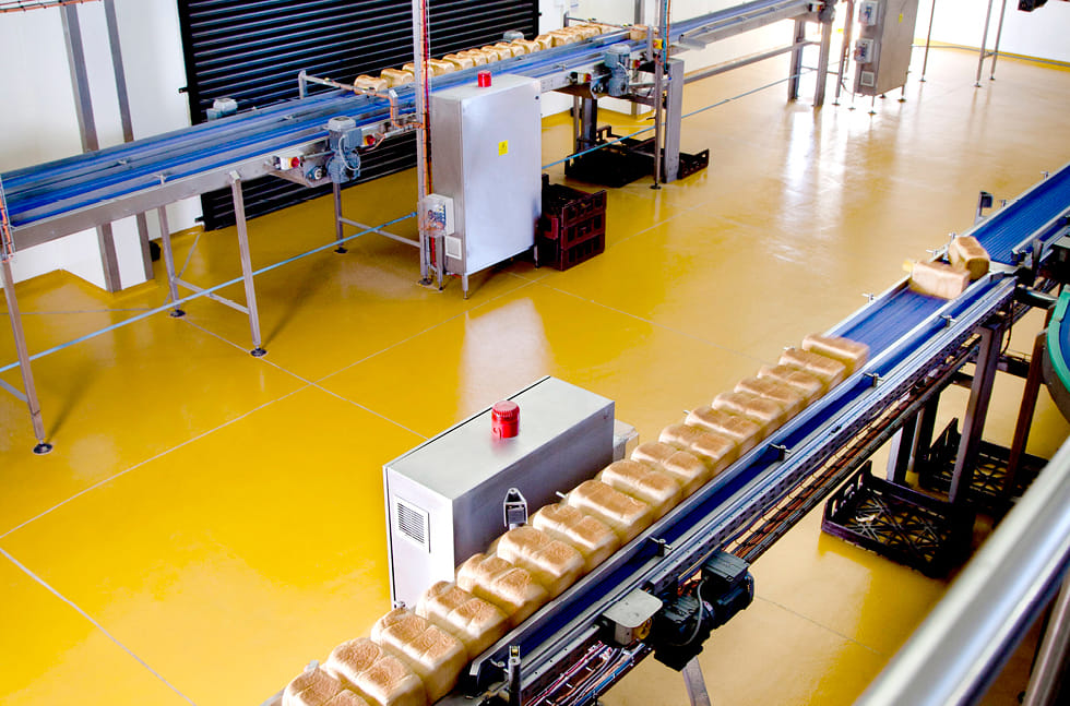

I happen to have an image on my desktop somewhere:
Think you can do the rest yourself?
main problem is production area..
this is just packing area

they suggest the same floor in your link as is in the picture I posted...also simply doing a google image search 'bakery floor' will give you exactly what you're looking for, even with installation pictures and everything.
Silikal Dexotex, Stonhard will all make industrial flooring systems that will be USDA approved for commercial food uses and will have load capacity for wheeled traffic. You are looking for resinous flooring, either polyurethane or epoxy based. Epoxy floors come in more colors but are subject to UV damage.
