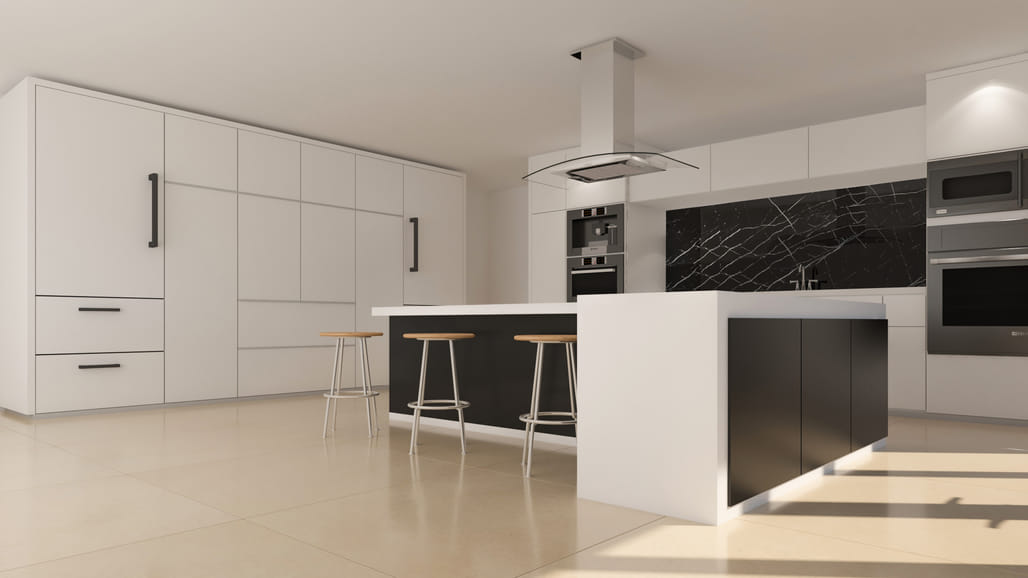

Below are renderings of my kitchen island. The white is a quartz border that wraps around the island. On top it is 3" thick and I want it to look uniform. I was advised by a kitchen designer that the bottom should be thicker, like 3.5" in order for it to look even all the way around. The designer is adamant that this is an optical illusion when you look down and if it is 3" on the bottom it will look smaller. So it should be intentionally made bigger.
In her words "Take a look at the various compensations made in classical Greek architecture to make various things look Flat, Parallel, Straight, the Same Size, the Same Distance apart by using bulges, tapers various sizes and uneven spacing. They had it all figured out."
Kinda makes sense but I have no idea who I could ask for a second opinion on this. Based on my other thread I was sure the architects here would have an opinion. Should I make the bottom thicker by half an inch? The same size? Some other size?

True-
BUT the scale of distortion being referenced is a temple at a distance, not a counter you are 15' feet away. The easy way to test it would be to was a two strips of paper, 1 3" thick and the other 3." inches thick and tape it to your existing counter and ask if yourself if the distortion you see matters to you.
Is there something wrongs with trusting the designer you’ve, hopefully, paid for their advice?
Or, is this the case where this person is brushing you off because you ask complicated design questions and expect answers, and their time, for free... hence asking random strangers online?
I would ask her/him why is it vertical on one end and not the other. Also, I would advice against using a white material at the floor level, but you will use it and will remember me after you have a party and people sit on those stools. Toe kicks exist for a reason, and they are usually 4" tall.

I would make all of the cabinet bases 4" tall. Partly because I agree with your designer, and partly because any less becomes a toe-catcher when you're actually trying to cook. Plus 4" is standard.
Nice looking kitchen, BTW. I like the asymmetrical island design. Making flush-looking appliances truly flush is a PIA but it can be done.
Entasis as a correction of optics is conjecture, not fact. Toe kicks being a standard height? That's a fact, but you can ignore it if you feel so inclined. Just send JLC a few beers every time you think about it.
The reference to Greek architecture doesn't really apply, for reasons others have noted. But your designer is correct anyway. An example that's more similar in scale and viewing distance is the matting of a photo or artwork in a picture frame: if you make the distance the same all the way around then the framed item will usually be perceived to be closer to the bottom of the frame (I say usually because in some cases this perception can be altered by the composition of the photo or art - but that's not an issue in your case as what's framed is a solid uniform color.) Usually you don't center the piece in the matte - you locate it so that the border at the bottom is about 15% wider than the border at top and sides - and then when it's hung on the wall it appears to be centered.
Oh and also: if you have a robovac it will get stuck unless the toe kick slightly exceeds 3.5 inches.
Let me ask this another way. Let's say the designer is wrong about the optical illusion. But if I made that bottom edge 3.5" anyway would the variation be noticeable? And if it is noticeable, would it look like a mistake or might it look intentional?
There is an unrelated reason (nothing to do with optical illusions) I would want to make the lower edge 3.5" instead of 3", so illusion or not, if it will look OK I want to do it that way.

IF your room is big enough that you can get several feet away from the cabinets, and it looks like it probably is, the difference of 1/2" will be noticeable to detail-minded architects and craftspeople. Most people would not notice or care either way.
Everything looks different in a 2-D elevation or even a 3-D rendering than it does in real life. Everything.
I like the surface mounted doors and no overhang tops where everything that gets spilled goes straight into the cabinets. Brilliant. And somebody was (presumably) paid to do this shit.
Like others I think the height looks fine but I'm more worried about having it flush to the cabinets (or even projecting out from them--it's hard to tell). You really DO need a toe kick at any functional cabinet space, otherwise you really do stub your toes and hurt your back trying to stand at the counter and worse yet, you will constantly take chips out of that thing with the vacuum.
I appreciate everyone's concern about my toe kicks but I do have toe kicks everywhere there is counter space. There is no toe kick on the sides of the island or under the island overhang because they aren't needed there but there is a toe kick on the front (cooktop side) of the island.
Ze plane! Ze plane!
Thanks guys.
My existing kitchen isn't a good test bed for testing with paper strips, as someone recommended, but I suppose I could just tape them to a wall and see how it looks.
I like how one will likely need a step stool to take anything out of the microwave.
So what is your decision? Sorry for the snark--designers and architects have very thick skin, and assume others do (or should) as well.
