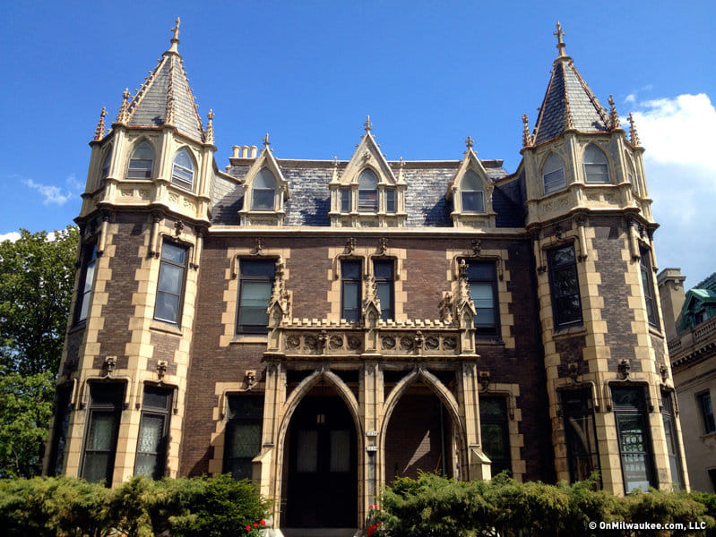

There was a style called 'North German Brick Gothic' in areas of Germany where stone was not readily available.
Here is an example (from Milwaukee, Wisconsin, no less) Although these columns are not brick they do extend above the roofline of the porch entryway.

"Here is an example (from Milwaukee, Wisconsin, no less) Although these columns are not brick they do extend above the roofline of the porch entryway."
That does make sense, although I didn't know that was considered as a part of the column. That's why the "column continuing above the roof" part confused me.
