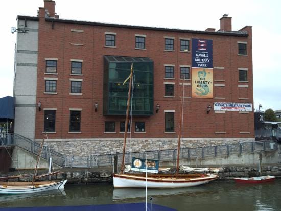

The first building is the Buffalo Naval and Military Museum. It was designed by Flynn Battaglia Architects in 2007. It is part of a master plan for an entire Erie Canal-themed district called Canalside. Local architects, activists, and politicians argue that the architecture borrows from buildings that once stood here.

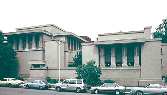

The second building is in Chicago and appears to borrow elements from Frank Lloyd Wright's prairie style.

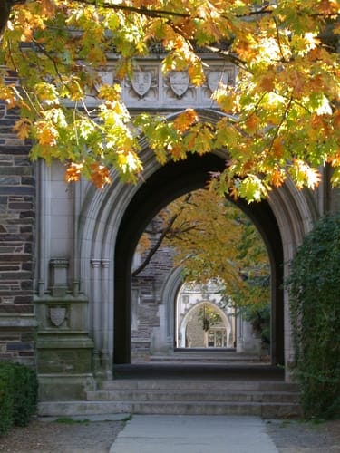

Well, this is the historical fabric at Princeton. Not a foam cornice in sight. A lot of the Princeton collegiate gothic buildings were built after the first skyscrapers, so they were anything but contemporary when built.

Well, that is a select view of Princeton. There are many buildings that do not look like that, including the building that contains the school of architecture.

can you shoot an arrow through all three thresholds? and who was the lord of the castle?, I see more than one blazon above the arch.

There are many building at Princeton that DO look like this and, in fact, it is the signature look of the campus.

I guess this is where I encounter "timelessness"... The buildings that are being built now do not look like this. These buildings were being built around the 1910s. I feel that this time-related bit of context matters quite a lot.

Actually the recently completed Whitman College at Princeton looks EXACTLY like this.

The first building is based on a type of Erie Canal-era warehouse building that used to be common in the area.
The second building is in Chicago and is derivative of FLW's Prairie style that was developed in Chicago.
