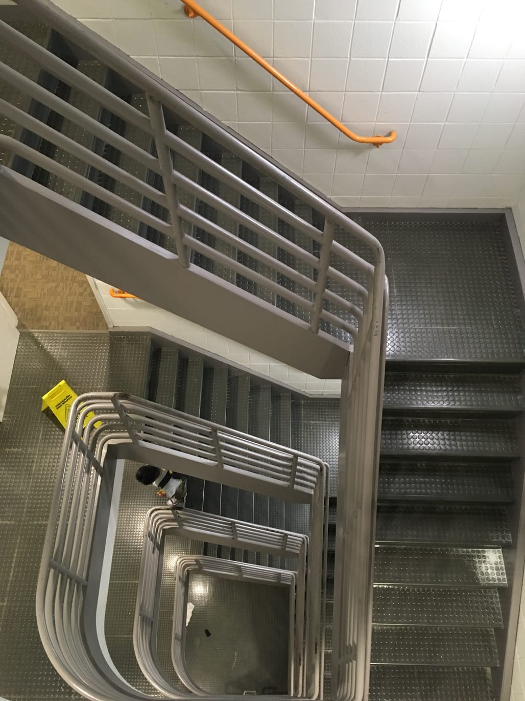

I live on the 4th floor in a college residence hall that has a continuous stairwell going up five floors (first picture). I am quite concerned whenever I look down the stairwell from the top floor. The railing is not particularly high and someone (maybe a drunk college student) could easily fall right over and drop >50 feet below.

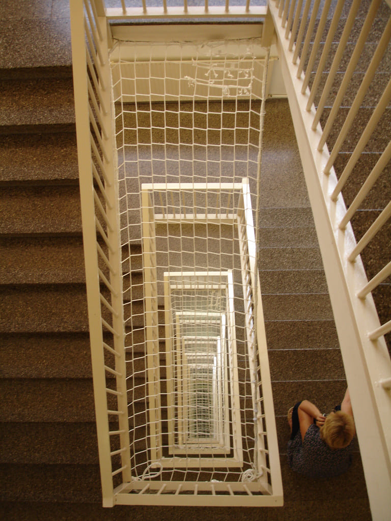

I am attempting to convince the office of residential life in my school to install some sort of safety netting (like second picture). Do you guys know of any city code regulations addressing this issue? Also, what are these nets called in architectural jargon and are they common? I've definitely seen them in several public buildings. Who would you approach to have these installed? Also, what are the conventional methods in ensuring safety regarding high vertical columns of empty space?

OP: it is possible that the stair railing is not per code. If not, it should be cited and remedied. Measure from the nosing of a stair tread (i.e., the furthest point forward on the stair tread--the point where it transitions from a horizontal plane to a vertical) straight up to the top of the highest horizontal railing. This must measure minimum of 42". I can't think of a single code that wouldn't require 42" guard at both stair-side and landing for an open stair in a multi-unit residence. However, it IS possible that your particular local code doesn't require this, and it's also possible that the "ladder" style (continuous horizontal bars forming the railings) are either legal or illegal--this one varies by location. To find out for sure, you can find the building code for your particular city through googling:
Step 1: google your city name and the words "adopted codes" and you'll find some kind of city government website telling which code has been adopted by your city. They may have a link directly to an online version of the code, or
Step 2: search Am Legal website for your municipal code.
Step 3: find the building code sections within your municipal code, and/or locate an online copy of the reference code the city has adopted for buildings. Usually this is something like IRC/IBC 2009, etc.
Step 4: once you've figured out your locality's code, search in it for "guard" height (that's what the railing is actually called). There should be a section of code dealing with "egress stairs" (technical term for this stair) and it will tell you all the legal reqmts for this stair, and you can check if all yourself.
Step 5: if the stair is not up to legal code, it doesn't make sense to go to your university about it--just call the local building dept and say you want to flag a non-code conforming egress stair. If your city has a functional government they'll eventually get around to sending out a bldg inspector who will then cite the university for a violation and make them brjng the stair into compliance (i.e., replace the railing).
That said, if your railings are minimum 42", it is 99% likely they are perfectly legal, and honestly that is plenty high enough to prevent all but the most determined Darwin-award-seekers from accidental death. So... I would not recommend installing nets. They will do nothing but catch constant amounts of trash and shit college students will throw down them. They will be trash-filled gross nets and the janitors will hate you.

Local codes always vary but there are two codes in play here. Handrails (34-38") and Guardrails (42"). Guardrails are to help prevent the falling over the side as you've indicated. This is the conventional method you are requesting.
If you look at the lower level landing you can clearly see a handrail at a lower height than the top railing. Without any measurement confirmation available, it appears the railings are adequate, subject to actual verification by a RA, PE, or local building code inspector.
