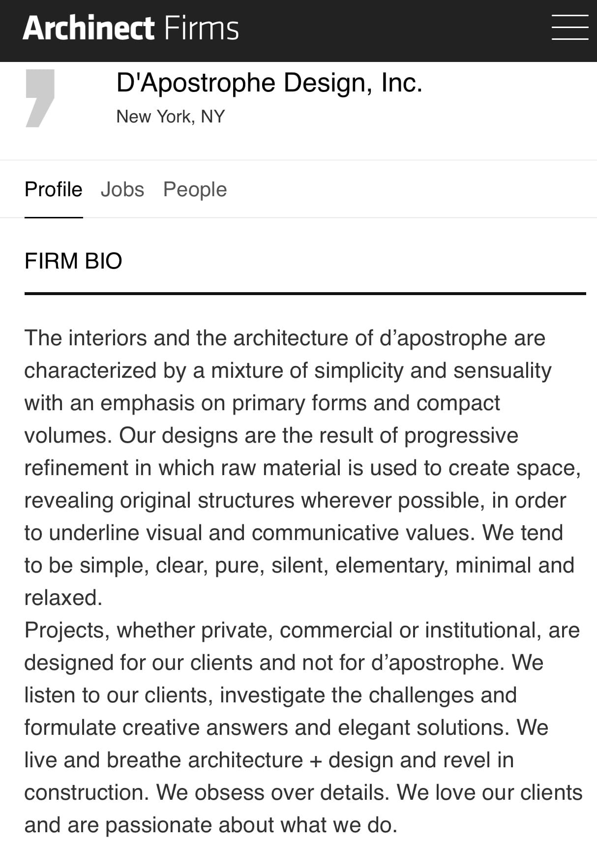

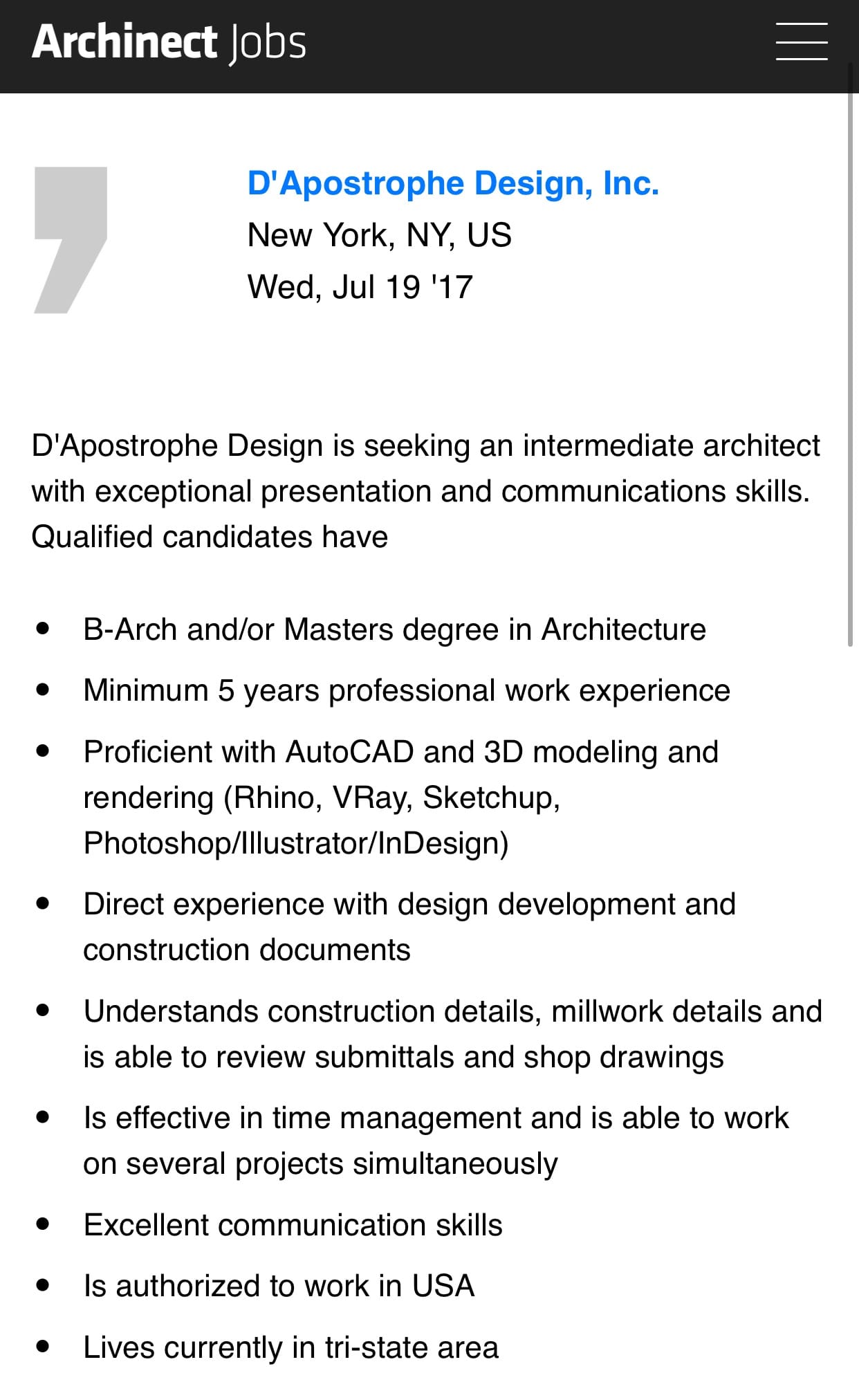

so offices like Mark Zeff and D'Apostrophe who post jobs all the time here would not be allowed to offer architectural services... not sure how they survived so long...
I can't tell you how many ID firms put that first sentence on their websites and its totally illegal if the firm is not an architectural firm with licensed ownership...
sorry:
http://markzeff.com/about/
