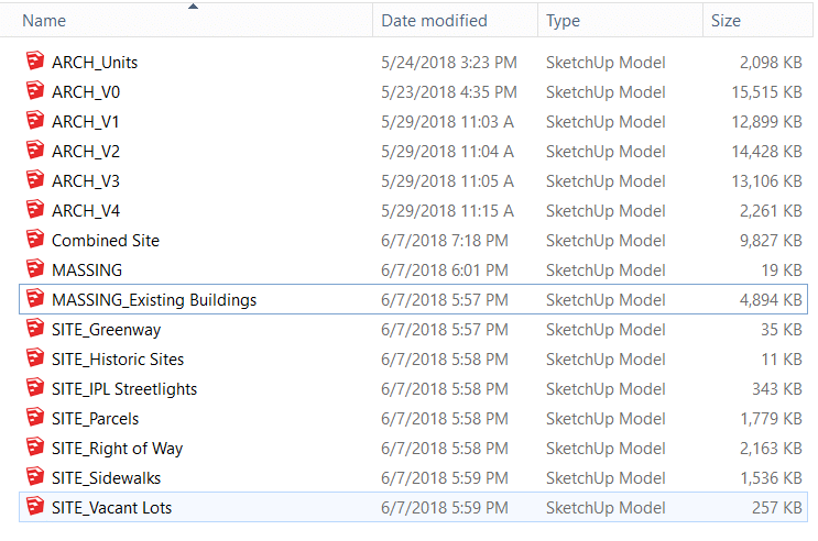

Its always smart to save a large model into many components and do a "save as" and keep them in a folder. I do a lot of urban design work across multiple city blocks and I will usually have each building saved out in the folder and  have a combination of "massing_building name" and "architectural_building name". This way a large file can take advantage of less detailed massing models while it is being edited. The components can then be replaced with the architectural model by right clicking, "reload instance" and select the architectural model.
This is also useful because you can make smaller changes within the individual architectural model in a separate SketchUp window then save it and update it in the combined file.
Here is an example for ONE project that I am working on. It includes ARCH iterations, a building massing combined file, SITE layers of GIS data, and then I have one Combined file which includes everything in it. I do not typically work from this file when it gets to big, but I just use it for renders and visual representation.
