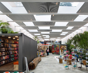

it's pretty cool that the havaianas flip-flop store in brazil using a shipping container to feature their "international" collection.
why can't more architecture be cool like that?

it's like stepping into a set...
lot/ek's organizations of the containers tend to be more compelling since they take advantage of creating spaces between the containers...
