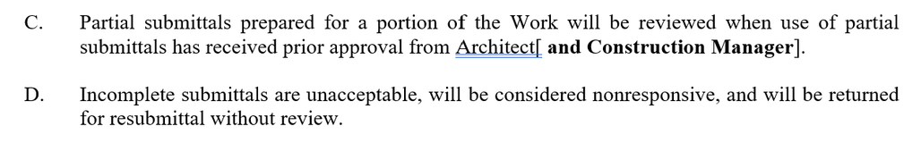

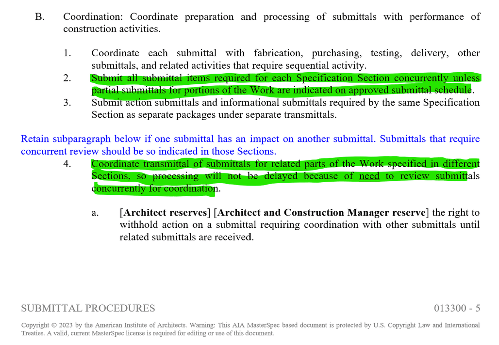

If you've got a MasterSpec subscription, you've got language there you can use. I can't overstate how ubiquitous this language is in the industry. Your big nationwide contractors will definitely have multiple projects they are working on right now where this is the case. Posting it here, including the copyright notice at the bottom, for educational purposes.
Near the end of the section, they even give you language you can use to reject incomplete submittals, and to hold them to submitting only partial submittals when previously approved.
