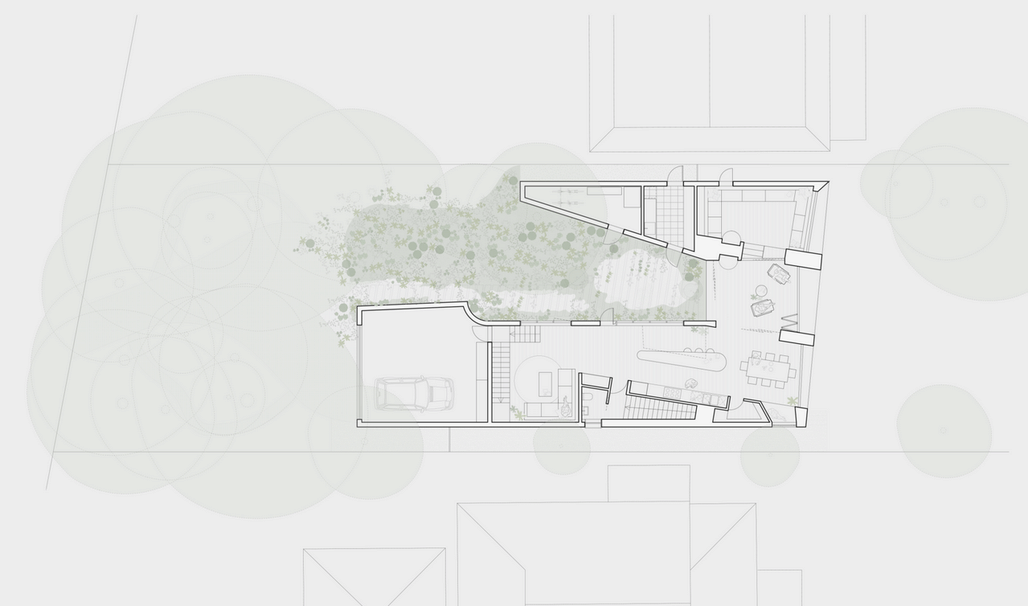

I think the pages need better layout and focal point. A lot of the linework images are hard to read at a quick glance and because they have a similar weight and you loose hierarchy. I was once told every drawing should have five line weights and had an old school teacher used to slam his hand on my drafting board and demand that I shown him one pen for each finger. No more no less. Yes I'm old, but the same still hold for CAD drafting.
Most portfolios will only be glanced at. Think about how someone's eye moves around the page and make that as easy as possible. Squint at each page spread. Where does your eye go first? Then Second, third, forth? Are all of those clear? For your pages I find I'm quickly drawn to the color graphic but then with the line work images my eye doesn't know where to look first and the frustration causes me to quickly look to the next page or bounce between images.
Things that could help include, heavier poche on section cuts, heavier ground plane lines on sections, adding atmosphere and depth to the drawings with shadows or exterior washes of color. Heavy, medium, fine lines. things look different on screen than in print and you need to over exaggerate the differences in line weights for the screen.
Think more superficially, more pages with a single image, or series of closely related images. Assume people will do stupid things like look at it at half size without enlarging to fill the screen or zooming in. It should still make an impact and leave a positive impression. The writing comes last you can do less of it. Label important things clearly but obvious labels like "elevation" or "section" can fade back.
Agree with JL , definitely need to turn up a notch ( not too much ) on line weight / back ground colour for sections, elevations, ground plane . Snip below is an example ( i would use light grey for solid wall though ) ...experiment is the key/ see how it looks
You're making good progress. keep it up.
This is a great example of the direction her line drawings could easily go to have more impact!
