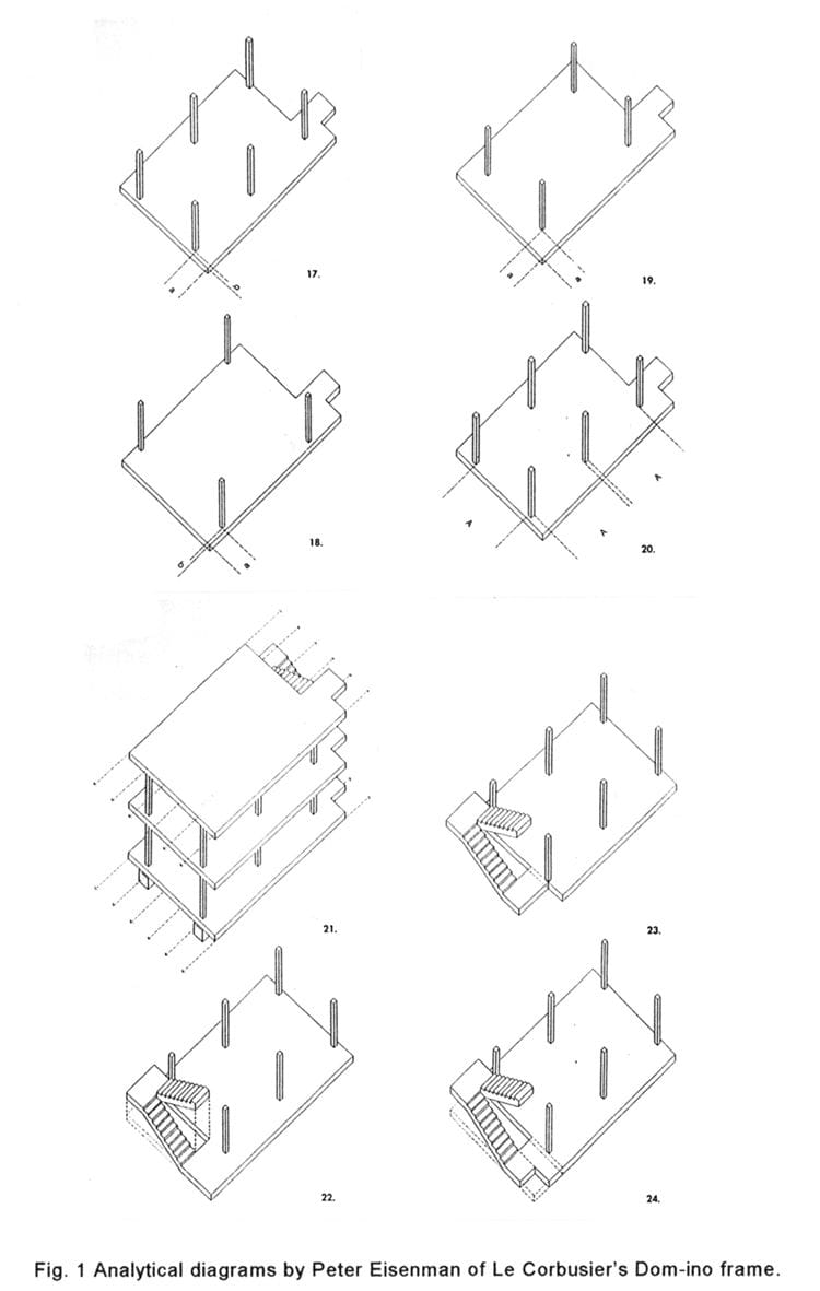

While eisenman maintains 6 columns always puching and pulling the edges of the slab off away from the columns:
And not slotting the slab between columns, but catching onto the clipped corner in fig 24.

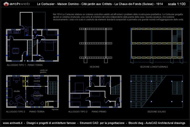

Last, is this image, presumably from LC originally, but found on afasia, shows 8 and is presumably another source for the mysterious 8th column along with the extended bottom floor slab:

my bet.... is that corb wasn't a purist about the formal reading of it (and could have done variations over time). the model in corb's foundation seems to most closely align with the axon (and quondoms, and eisenman). the hague model seems just incorrect. Rowe isn't really using the purist reading of the domino but the broader idea relative to a specific project. don't know anything about the arch-web version. the last drawing you have... you didn't cite a source but it could either be an earlier idea or a later idea (if it's from corb's archive) or for a specific project or....
Oct 19, 23 9:21 pm  ·
presumably these were multiple iterations of a conceptual idea. though clearly the 6 column version is more satisfying architecturally. maybe the foundation le corbusier or one of the institutions holding the models / drawings could provide more context on the history of each artifact. there isn't much purpose studying the secondary sources- eisenman or rowe. they're just illustrating the idea, not describing its history.
