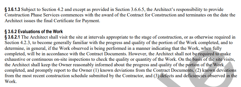

RJ87 - AIA contract B101 clearly states that the architect needs to visit the project during construction to ensure that it's conforming with the design intent. AIA contracts are not just 'framework to start from'. They are complete and concise contracts that are stand alone.
Sure you can modify the AIA contracts but you need to be careful.
For example, the B101 contract states in several places that the architect needs to take measures to ensure that the building construction conforms with the design intent shown in the drawings. This is in addition to the to site visit section of the CA portions of the AIA contracts.

"Construction Observation" is different than site visits to ensure that the work follows the design intent of the construction documents. If you don't remove every instance of the above in B101 then you have to do site visits.
"Article 1 "Architect's Responsibilities" clearly lays out that construction observation is not our responsibility. "
Actually article 1 of the B101 – 2017 does not say this. Article 2 is the architect’s responsibilities, and it says no such thing. Article 3.6 dose say:
Yes, Chad is absolutely right. If the GC and the client used the AIA Contract, then the architect is responsible for the above clause. In this particular clause, when a GC submits a PayApp for the works done, the AOR needs to visit the site and review the works against the design intent. Then, they need to report to the owner with those 3 options. Be careful who you have as your client, they can hold you responsible for this, as I have been past 2 years. :) I had our legal/procurement team to review this and the AOR is on the hook.
If your client and the GC signed this B101 form, then it is not a framework.. It is the fully executed legally binding contract.
Sorry, B series is the contract between the owner and the architect.

Chad: As I mentioned earlier, you're quoting a standard AIA contract that has language in it that you can change. Those contracts can be adapted to fit however you want to operate. The random contract I clicked on was a modified B105 for an outparcel (we have separate contracts for outparcels typically), not a B101. Article 1 in B105 is Architects Responsibilities & in OUR contract, it clearly states that it's not our responsibility to go to the site unless they provide in writing that they'd like us to go out for an additional service fee.

It all depends on what a specific contract says. The AIA does not matter beyond their STANDARD contract. Back to my 60 taco bells example, the architect isn't going to those.
RJ87 - I understand that you're using a modified AIA contract. There is nothing wrong with that. My point still stands - an unmodified AIA contract states that architects need to do site visits.

RJ8 - Regardless of how many Taco Bells one dose the standard AIA contracts do matter . They are well understood and widely used.
As I've said from the beginning you can modify standard AIA contracts all you want. You just need to be careful. For example: if you're using your modified B101 you need to make sure that an unmodified A103 contract isn't also being used. If it is there could be serious conflicts between the two contracts.

You can put anything you want in a contract. That doesn't mean it will hold up in court.
That's the part I find interesting.
"It didn't help that the owner / GC used a standard, unedited AIA contract. That contract stated the architect would be responsible for verifying that the work conformed with the design intent of the construction documents."
The architect isn't a part of that contract, so how would that be enforceable? If I wrote in a contract "If x-jla does not go to job sites, Chad Miller owes me $50." and only x-jla & I sign it, why would Chad owe me money? That's where I think it would only hold up in court if you didn't remove the tie backs to the correlating A10_ contract. Maybe its the standard of care portion, who knows. I guess that's why you become an LLC & carry insurance.
Since it was a standard contract that is widely accepted it was proof that the the standard of practice was to do site visits to ensure that the work conformed with the construction documents. The architects claim that his contract excluded site visits was deemed to be gross negligence since he was not be following standard practices.
It would be similar if you modified an AIA contract to say the architect isn't responsible for ensuring that the building design follows code.
That's the big thing. You can modify an AIA contract all you want. If it violates the "standard of practice for the region" (verbage in the A and B contracts) you could still be in the wrong. Getting sued for something like this and loosing would destroy your insurability. At the very least your premiums would skyrocket. I guess it all depends how much money your firm has.
