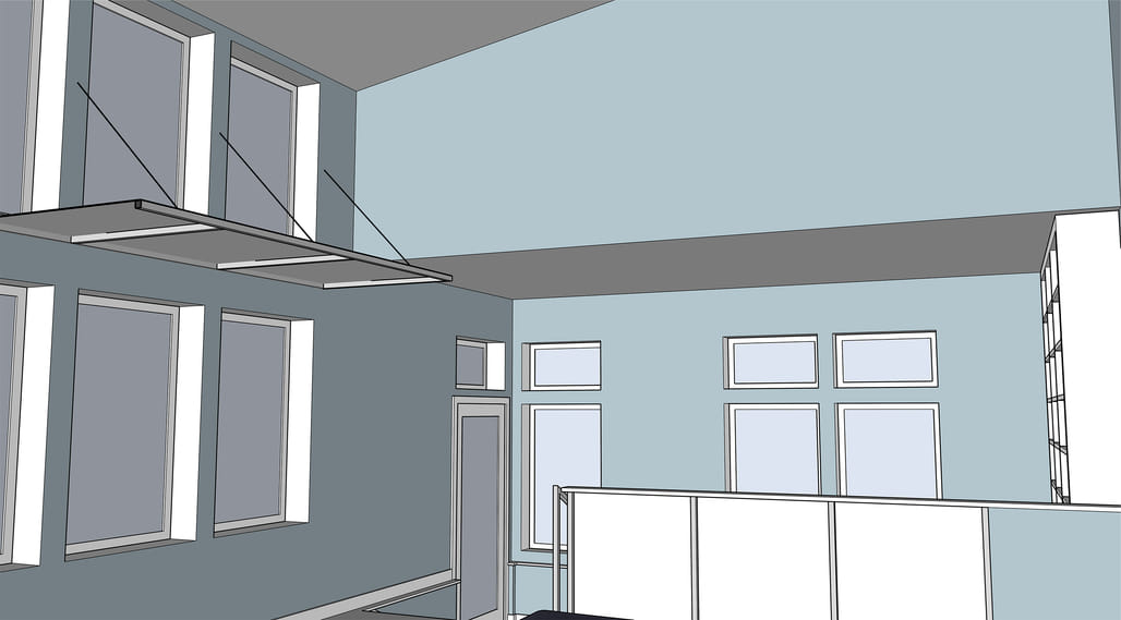

I'm working on details for a bedroom addition, which is to have a light shelf inside high windows and a see-through balustrade. We're leaning toward a stainless tube steel framework and would like a translucent white material for the field. Budget is a factor. My clients like to sail so I thought about sail cloth, but not sure how to attach it to the framework. Or polycarbonate, or some other modern, high-tech material that I may not even know about. What have you done or seen that works?

Holy dust collecting shelf batman... but joking aside, we've used white ceramic enamel frit glass before but not in a horizontal application. You can get acid-etched glass too if you don't want 100% opacity.
Haha, yeah it will be a dust collector for sure. The housekeepers will have to deal with it. I hadn't thought of acid-etched glass but that makes sense; we used that for the new entry door so it would make sense to repeat it.
ETFE or PMMA would be really interesting, but I don't know about budget.
I used Okalux for some clerestory glazing and it is an incredible material. Pretty cost effective too as it just goes in the air-space of an IGU. I've never seen anything transform daylight the way this does.
If you're leaning toward glass at all, you'll likely want laminated glass for code reasons ... and then you can just get a translucent white interlayer. No need for anything fancier.
Other options for membranes and plastic glazing as have been noted by others are good too.
Multiwalled polycarbonate sheets can be nice for these types of applications. Be aware that you only get UV protection on one side of it (at least I haven't found it with both sides protected) so make sure it's facing the right direction or you'll have some panels yellow from UV, and others look fine in a year or two. I've seen it happen when used in exterior railings, etc. It's less of an issue inside the building obviously, but it's also dependent on your window glass.
Is this for guard rail? Or Light shelf?

Both--I had originally designed a bookshelf as a railing and a framed, drywalled light shelf, but my client is artistic and wondered if we could do something more light and airy. I loved the idea but don't have experience with some of these materials. Thanks for your help!
