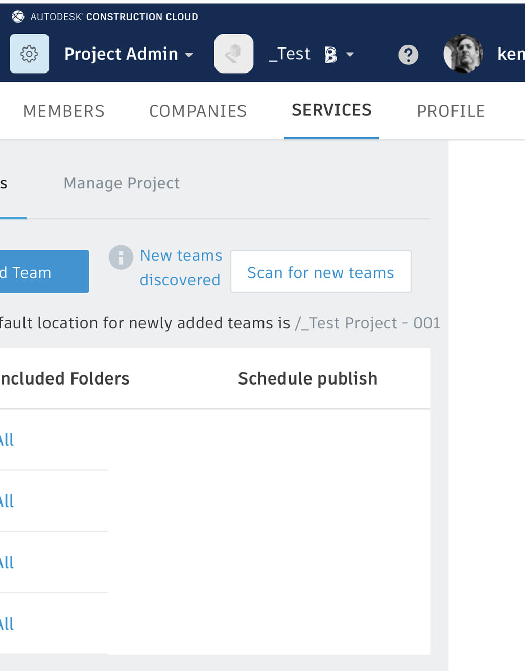

Actually, you can schedule publishing. What do you mean Copy/Monitor?

A couple things that always through me for a loop. You have to activate document management in the web browser, to be able to upload models to a project via Revit. You cannot host a .rfa or .dwg or .txt file (for key notes) on the cloud, so still need to be connected to your server. You can publish (back-up) as often as you like, but there is no way to set-up an automatic publish interval. Copy/Monitor is incredibly complex, and in my opinion limits the utility because of that.
