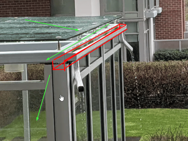

Like a lot of you I'm at home all day staring out the window, analyzing my environment and thinking about what could be improved. I think this would be a great spot for a show and tell of crappy design details that frustrate us.
It rains a lot here on the west coast, and despite nearly 150 years of industrialized construction locally, designers approach details here as if they had no idea it actually rains.
Below is a pergola for a fire exit from an underground parking garage. The apartments next door sell for around $1000 a square foot. At one point the penthouse was for sale at $10,000,000 CDN. Despite this it feels like they couldn't pay the designer for a few hours to come up with an elegant solution to rain water on the pergola glass.
In the rainy months (some ten months of the year), rain just runs off the glass into a trough and then dumps into the flower beds leaving mud that the landscapers are always left to deal with. In the summer, the glass is rarely cleaned and is filthy.
What's a design detail that frustrates you on a daily basis?
They could have simply extended the rectangular gutter over the planted bed, sloped it a marginal degree (wouldn't need to be visually obvious) and then just left the end off of it. Sheesh.
Bad sketch:
Haha , and that took you how long to figure out? Probably less prone to clog with leaves as well.
The stitch weld is driving me crazy.
how did renzo do it?
He didn't, which I love. Too many people solve "problems" that aren't actually problems at all.
just making the glass overhang enough; so a bit more money avoids future headaches, who would have thought?

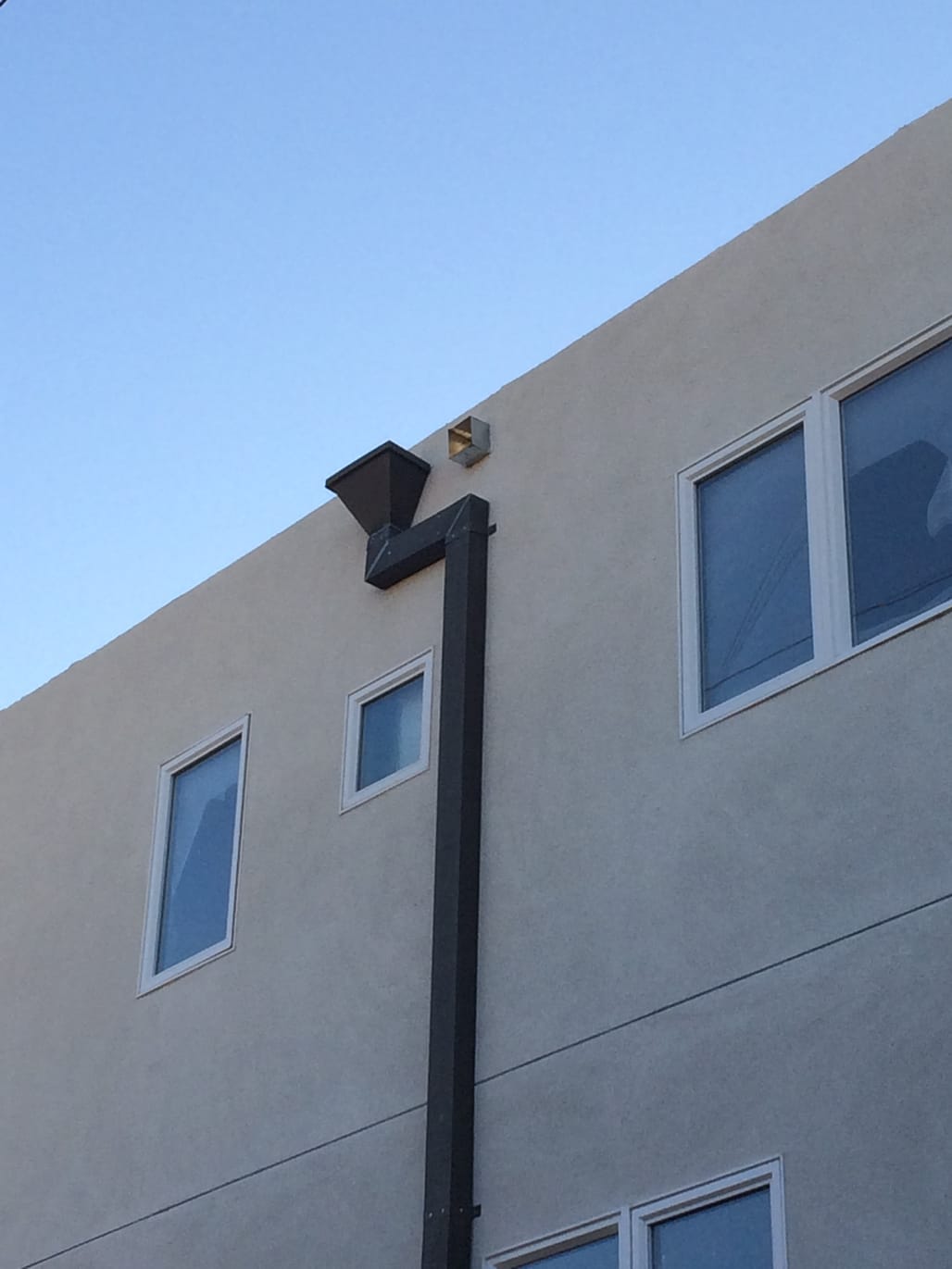

Woops.
Jesus. Make them redo it. It's just a swap of the main with the overflow. This isn't bad design, this is a contractor fuck up.
wtf... unless there's a legitimate reason for goose-necking the downpipe and hopper then that's a bloody lazy job!
Architect laid it out so the overflow would be above the glazing and the pipe would run straight. Contractor installed the overflow where the main was supposed to be and this was the solution. Either the architect lost the RFI fight or there was no RFI.
missed it by that much! ( get smart reference )

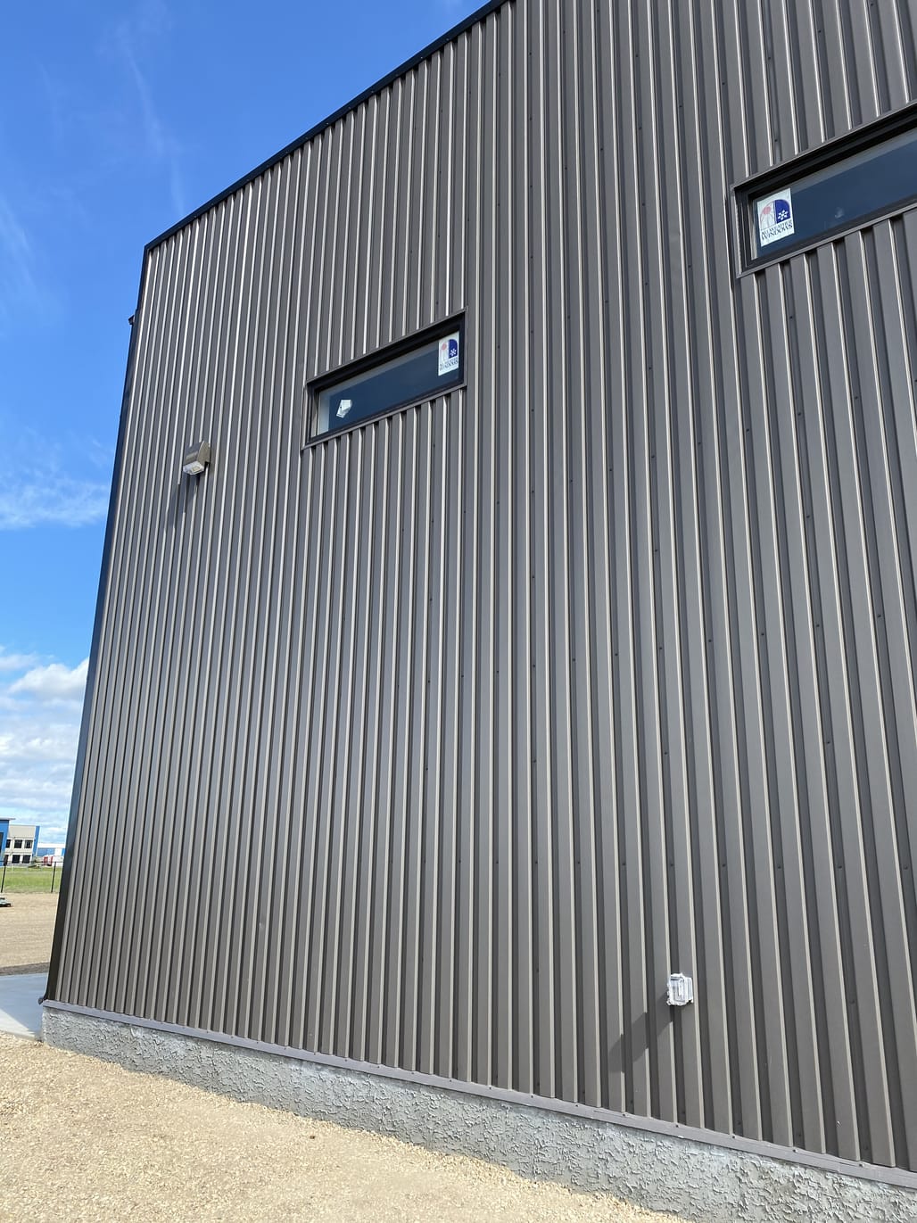

This surface mounted receptacle really grinds my gears.
What's going on with that stem wall finish?
That parging on protection board on rigid insulation on a 1200mm deep concrete grade beam. We have high plastic clay here so we use pile and grade beams, not foundation wall on footings.
My questions are not to challenge your design, I'm asking because it's unfamiliar to me. Does the parging get damaged with weedeaters and such?
It’s a cementious product that is cheap and easy to reapply. Not sure how it would hold up to chemicals but our winters here are rough on exterior finishes near grade. Especially anywhere near snow removal and ploughs.
I think an off-the-shelf flush mounted while-in-use receptacle is a unicorn. You can do a recessed cabinet to house an outlet if it's NEMA rated, but those are also not pretty.
Almosthip7 - I recognize that window manufacturer. And if the owner is cheaping out that much with fenestration, I'm sure the receptacle mounting is so far off the radar it's funny.
It’s a shop in northern Alberta. Pretty sure his going to lose more heat out of the 6 overhead doors opening and closing all day than that window

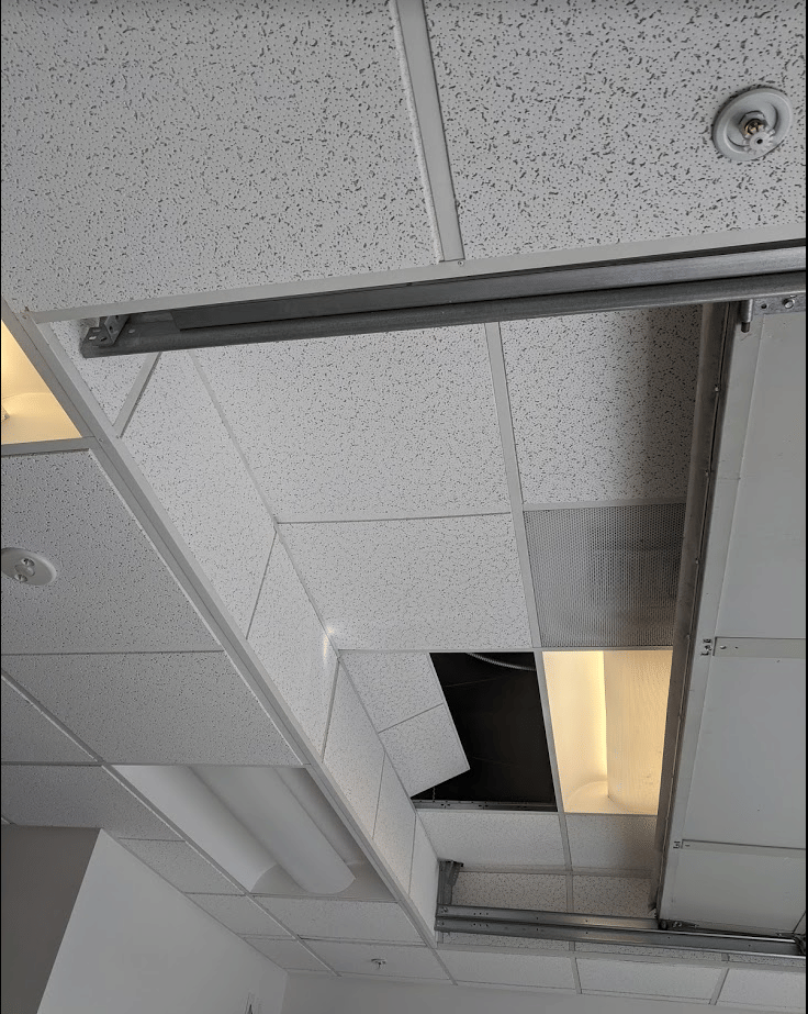

Encountered some - uhm - creative ceiling work today.
Yes that's an exterior roll-up door.
Wow. That's...
Impressive.
My mechanical p.eng would have insisted on a run of sprinkler heads directly below the door to keep 100% even when rolled up.
::tilts head:: WTF, I mean, huh?
NS one of my engineers did this to me recently. Wtf is going on? Are we even allowed to design any more?
what kind of space is this?
BB, I've had many such conversations... and although I've not won all of them, I do think my win rate is above 50%. Usually I just mark-up the sprinkler shop drawings and ask the fire-protection sub to provide the angled-type sprinkler head and drop it below the level of the open door but to keep it to the side.
mid - trash room / loading. at least it's BOH.
Also just as a disclaimer this is from an existing building a client is moving into. It's an old utilitarian cubicle array. Lot of 70s era, drop ceiling, grid lighting, off-white, dirty carpet ...depressing as fuck. Wouldn't want anyone to think this was my work. I'm hoping to fix it.
I have a project with sprinklers I'm proud of, but it would immediately out me and I'm not ready for that. Suffice it to say that I think a good sprinkler contractor is worth their weight in gold.
it's well done, couldn't criticize the carefulness of the detailing or the installation. it's just strategically absurd. needed an architect earlier in the process :)
nice finishes for a trash room...
You're not wrong midlander
