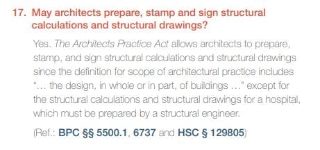

https://www.cab.ca.gov/docs/pu...
According to this we can sign structural drawings in California. Which is counter to everything I thought I knew.

Also for reference, I still find it hard to believe that we don't need them per the letter of the law. So if anyone can find it feel free to share.
Only for certain project types in certain counties in certain states. The snip you posted above about CA - individual counties in CA can and do make the permitting process more stringent and require an engineer regardless of what the state says.

Ask your AHJ. I can't speak for FL, but here in CA, that is determined by the AHJ, not by the Architects' and Engineers' regulations.
(Example: Statewide, and architect can design any building of any size without any other engineers, but in the City and County of Los Angeles, a Structural Engineer may be required based on building height, and for DSA and OSHPD, all engineering disciplines are required for all projects of any size.
