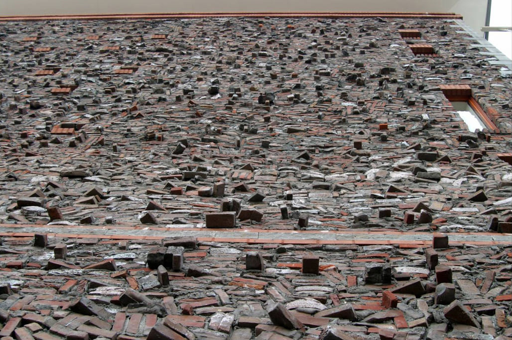

the inch" symbol is what put people on the moon. Metric engineering sucks.
i've been looking for an opportunity to stick in a detail like this.

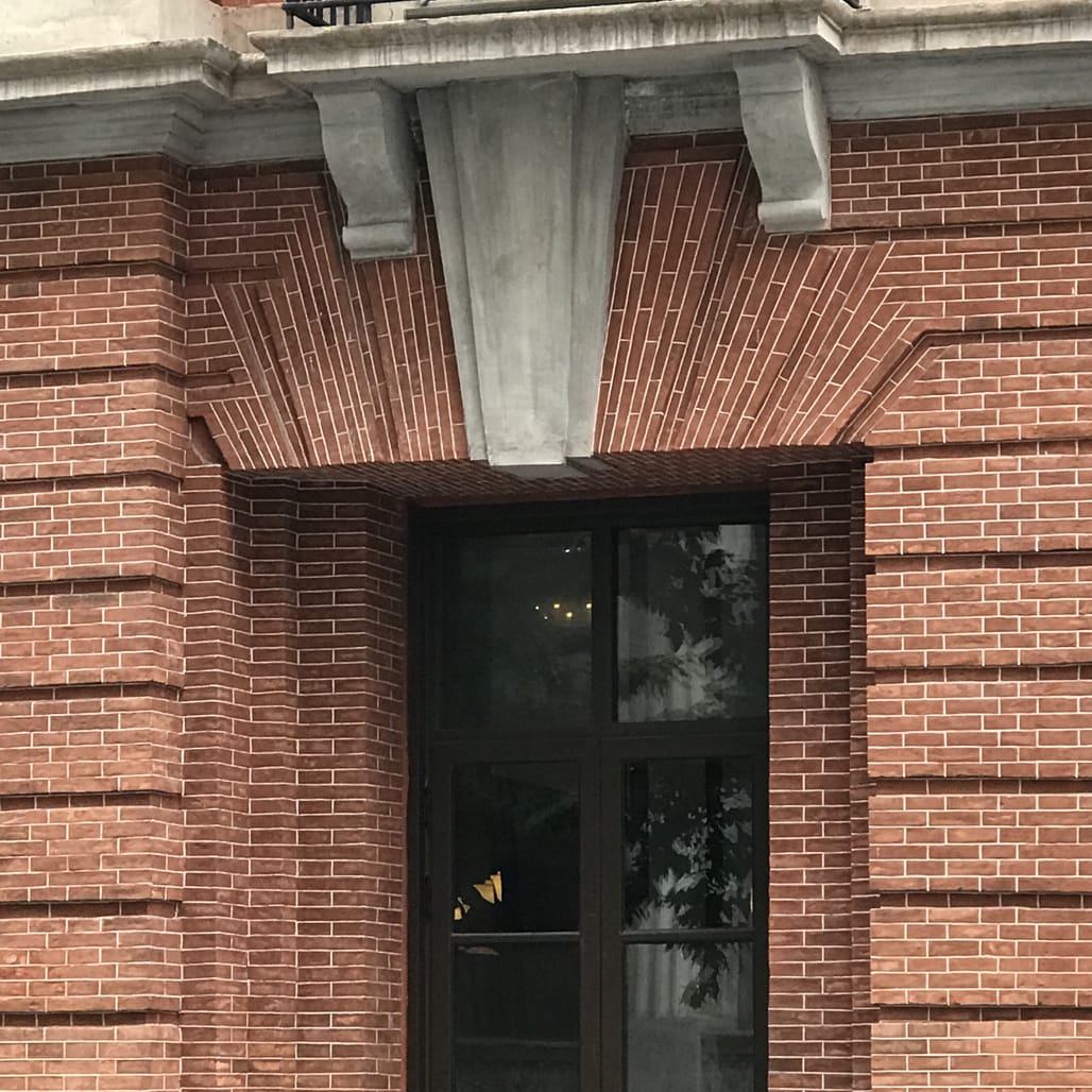

I love the offset of the two flanking brackets.
Jun 20, 19 2:34 pm ·
joseffischer
I like to think this was centered during DD and got stretched 2 days before the CD deadline. The Architect and GC argued about some other part of the building during CA where the architect said something like "I'm the architect, dimension it how I showed it" and the GC decided to get his revenge here.
Jun 20, 19 5:45 pm ·
that would be Romans rather than Greek
Jun 20, 19 7:13 pm ·
The asymmetrically placed corbels make it even more ... something. Delicious? Disturbing?
Deliciously disturbing. But not as much as all those thin tapered bricks that somebody went to an inordinate amount of difficulty over.

Punishment for an unruly masonry apprentice?

actually i was interested to see some comments on the crazy amount of irregular and cut bricks in the flat arch. the asymmetry is strange but also less fascinating.
fwiw this is a historically protected building built in 1908. as far as i can tell these are real bricks not facing bricks, which makes this only more perverse.
That's a jack arch. AKA flat arch.
