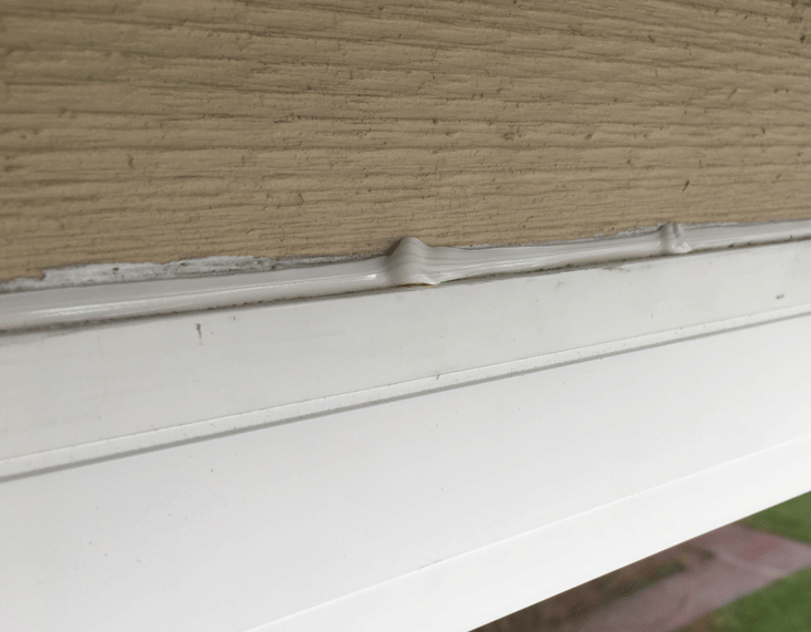

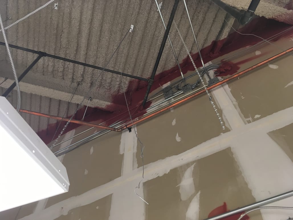

So... it's not caulk.  But it's a joint.  Or maybe they were smoking a joint.  I'm really not sure what the fuck happened.

I gotta stop looking at this stuff. It's making loose faith in humanity.

Almosthip7

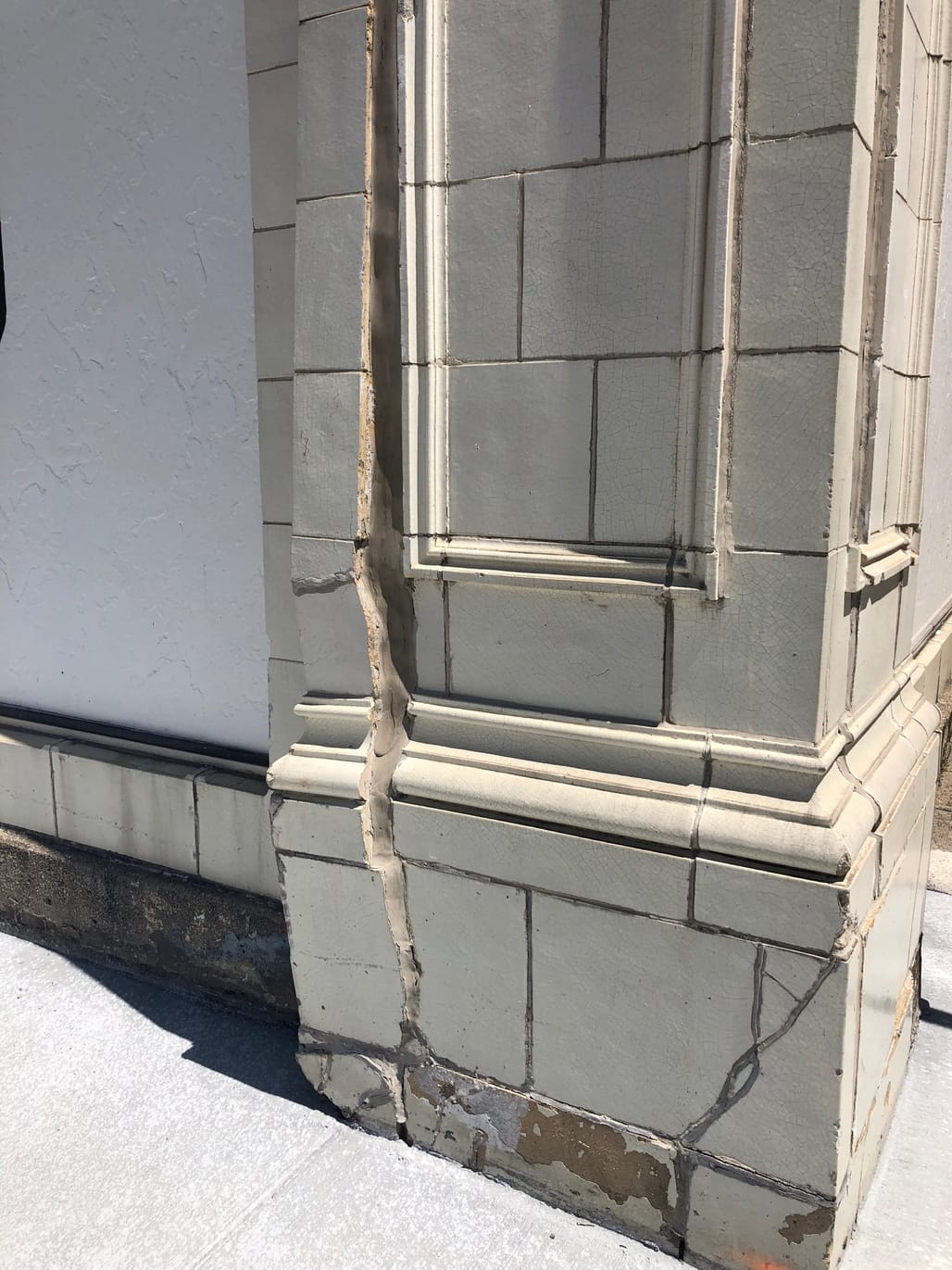

I think they missed a spot
Aug 28, 19 6:43 pm  ·
SWEET BAILEY STUD!
Aug 28, 19 7:17 pm  ·
I'm sure this will work:
Aug 28, 19 7:21 pm  ·
This one too:
Aug 28, 19 7:22 pm  ·
Looks like cake frosting.
Aug 28, 19 7:29 pm  ·
Hey dawg, I heard you like caulk so I put some caulk on your caulk:
Aug 28, 19 7:24 pm  ·

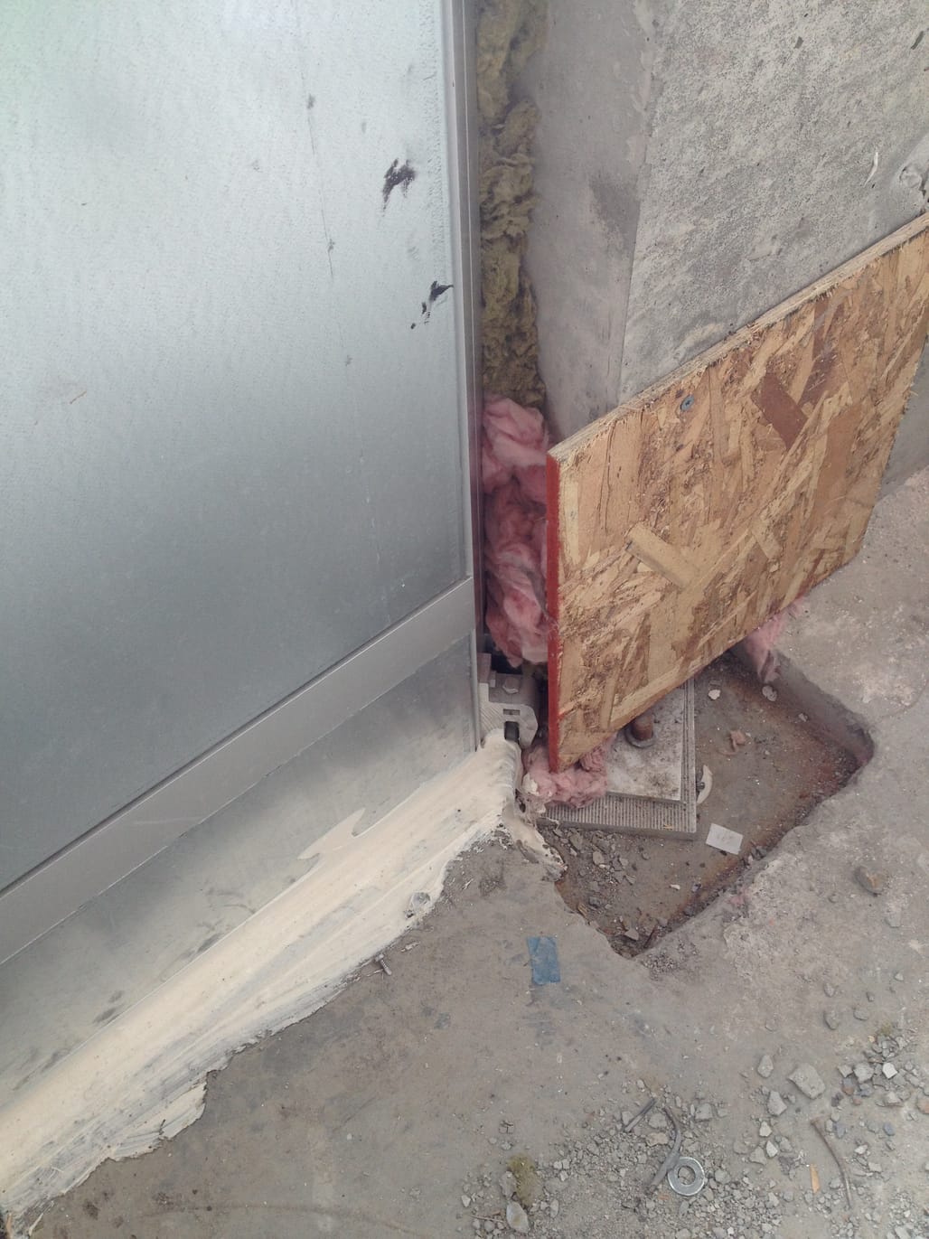

Fine, Non Sequitur, here you go:
This is one block from my office. I avoid walking on that side of the block when I can.

most excellent. a fine caulk example

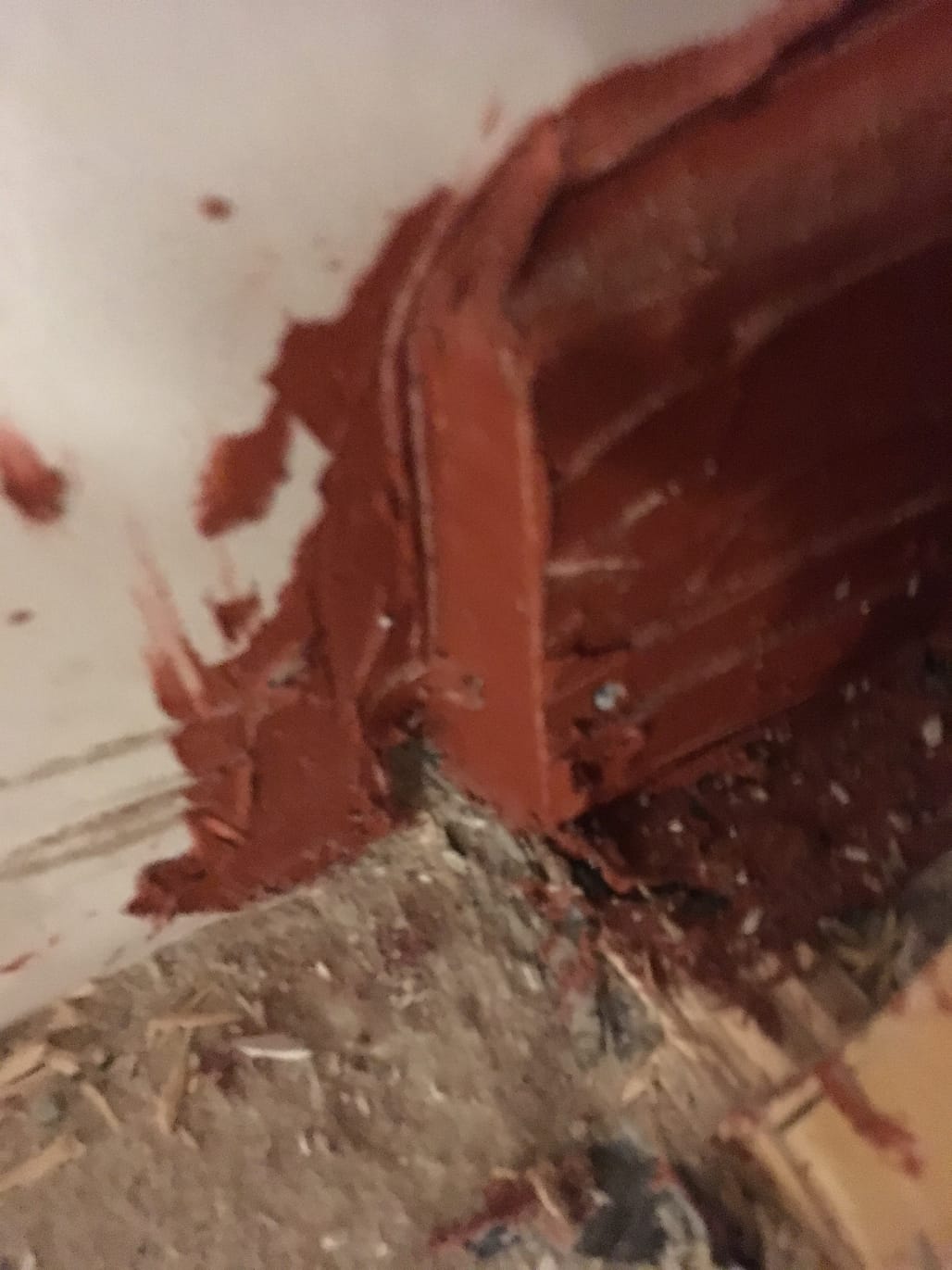

I've got a few good photos at work, neither caulk, but one is of plasterboard with 1/2 inch gaps and wonky cuts: the other is of external steps built at different heights..
Makes me wonder, are folks paid based on how many empty caulk cartridges they have at the end of day?

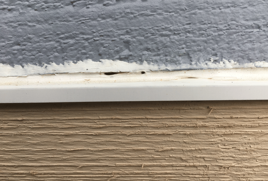

Photos below of the sealant the window installers tried to get away with on my house.
From the agreement I signed with them which they drafted (i.e. this is what they said they'd do), "In order to provide optimal seal, caulking to the exterior must be tooled or spread.
Also, from the data sheet of the sealant they're using, "Fill the joint completely ... and then tool to ensure intimate contact of sealant with joint walls."
You've got some nice tooling there. That installer is a tool. So is that one ... and that one. Maybe you can send one more tool out to fix these other ones.
Mar 17, 22 7:28 pm  ·

NS, they've got a French version of the data sheet for you too. Not sure if it translates the same though. https://www.tremcosealants.com/markets/commercial/sealants-adhesives/hybrid-polyurethane-sealants/dymonic-fc/
Also I lol-ed at the line just after where it says, "Dry tooling is always preferred." I don't think that's a universal opinion, but you do you.

Use tool properly to create intimate contact. Evergreen.

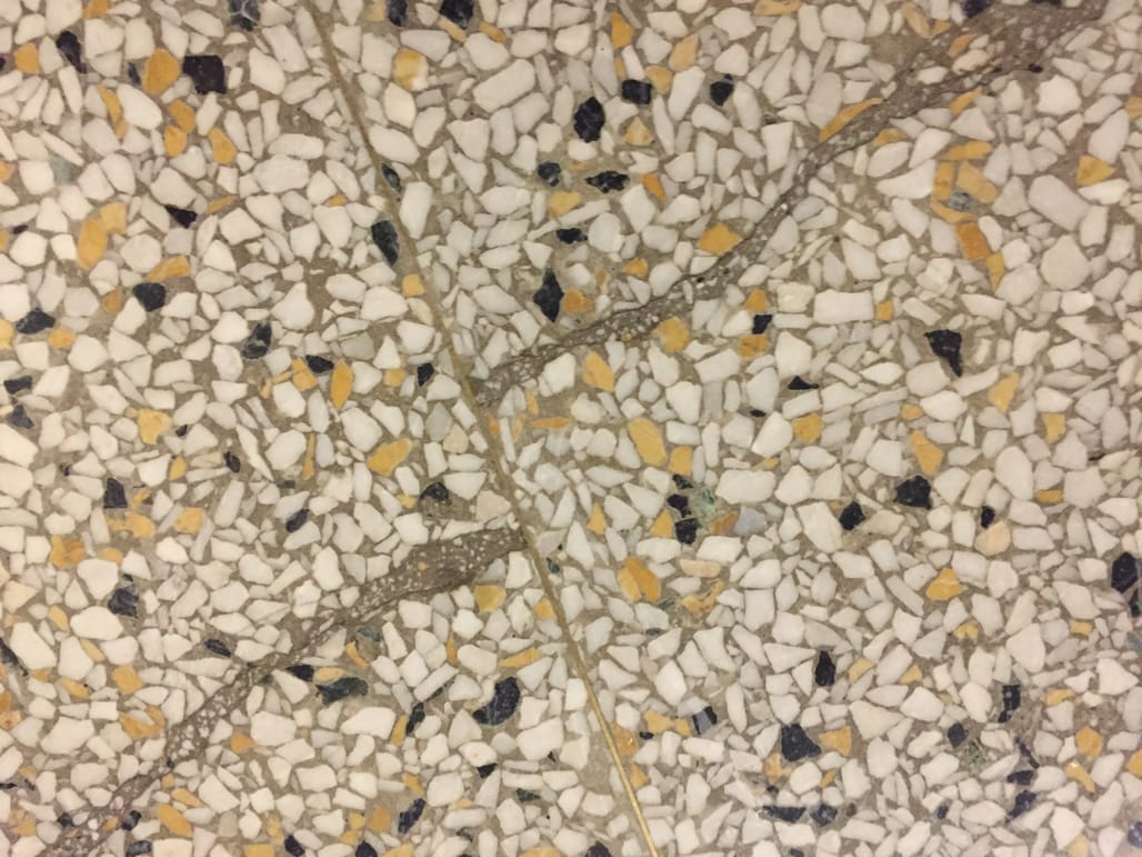

So these are not caulk, but I like them. I’ve had these pics on my phone for 6 years now. This is terrazzo floor repair at historic Shortridge High School in Indianapolis, alma mater of Kurt Vonnegut and my son. It’s repair work done with great care.

I don't have any pics to share, but there are some contractors that specialize in repairing terrazzo and it is truly amazing what they can do.

are you familiar with kintsugi? seems similar.
