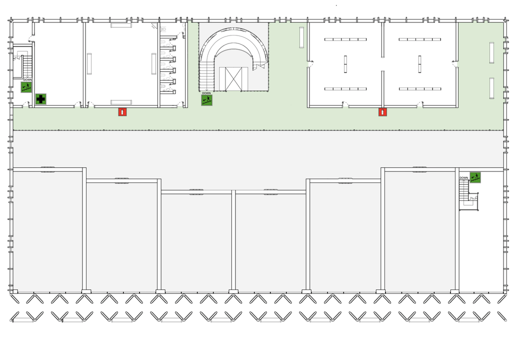

hi! because fire exit stairs on the left are in a fireproof enclosure - should the arrows direct them to those stairs past the main staircase in the middle or shall I treat both sets equally and whichever is closer, you choose that. the room on the bottom right is a standalone space on the 1st floor.

Be sure to look at : Common Path of Egress Travel, and the Exit Access Travel Distance. This will be based on your buildings occupancy type. When doing so you need to count the distances traveled within the stairs. That is unless the stairs are exit access stairs.

As far as the actual answer goes - in most jurisdictions I've worked in (15 years professional experience culminating as a high-level PA/ Senior Project Architect at some of the best firms in North America, if not the world) there is not a straightforward answer to this. Or rather, when drawing an exit plan, the answer to where the arrows point is "where the fire marshal says."

This drawing is hard to read… however, I’m willing to guess you need two exits per 1006.3.4. It seems likely you are not going to meet dead end requirements per 1020.5. You may also be failing to meet separation requirements per 1007.1.1 both in the overall building and potentially within individual rooms depending on occupant load. As said above, common path of travel may also be an issue. There are a lot of other issues, but those are topical thoughts. (references are 2021)
Not sure what you mean by arrows exactly, are you talking about exit signs (presumed), wayfinding in the building, or life safety drawings?
I honestly think this is a challenging question, although as archanonymous says above ultimately, at least in the US, the fire marshal tell you what s/he wants done, code book be damned.
But the interesting question is: should a non-compliant stair (for example a grand staircase open through three+ floors) have egress signage? Is it better/safer to get someone out of the building quickly, or to get them into a smoke-proof enclosure quickly?
How do you know it’s 3 stories? If it is, then the comments above about the atrium issues apply.
But yeah. I’m with Chad, AHJ can allow whatever but that doesn’t mean I’d toss code. If the AHJ lets you do something non-compliant you better have a good reason and a well thought out solution. If they are just blatantly letting you do something non-compliant on a major element of a new building…. Just make it compliant.
Typically a non compliant stair cannot have egress signage. The most notable exception to this are in the IEBC when dealing with historic buildings.
How do you know it’s 3 stories? If it is, then the comments above about the atrium issues apply. But yeah. I’m with Chad, AHJ can allow whatever but that doesn’t mean I’d toss code. If the AHJ lets you do something non-compliant you better have a good reason and a well thought out solution. If they are just blatantly letting you do something non-compliant on a major element of a new building…. Just make it compliant.
