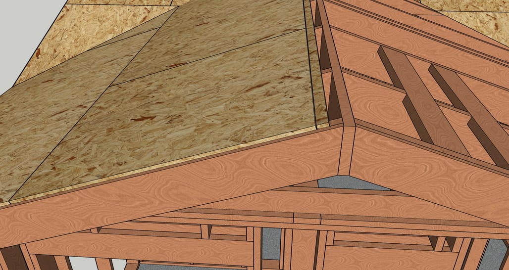

Hi everybody,
I'm learning the ropes of roof framing and have come across an issue with my cabin design. The ridge gap at the top of the sheathing is ~3.5" on each side. I could fill it with a thin strip of OSB, but also plan to put a ridge vent there and am not sure how that all might fit and/or be structurally sound, considering that thin strip would probably be less than 2" wide in order to leave enough vent gap.
My other idea is just to close the gap completely and vent it another way, of which I still think that 3.5" thick of OSB strip might not be great.
I saw that there are wider ridge vents, but I wasn't sure if that large of a ridge gap is good for snow/etc. FYI - that's a ridge board and I put the thin strip in there to make that gap 1 3/4".
Thoughts?
Thanks!

You should talk to a local roofer.

What AA said. That or you can change the spacing of your first plywood sheet to be a half sheet. You're going to want to stagger the joints anyways so . . .

I've been there. You're correct that a 3 1/2" rip of OSB will not have enough structural integrity for this location. The solution is simple--rip off the upper few inches of the top sheet of sheathing and install a rip about 10-12" wide, leaving about 2" (1" on each side) for the ridge vent.

I've also personally just put a 1x up there to create a way stronger ridge substrate to nail to. This level of detail is sorta means/methods for your roofer to deal with though, unless you're just being extra and have fee to burn in your CD set.

Jose, good point, though it depends on the sheathing thickness. I usually spec 5/8" which would hide a 3/4" board under laminated shingles, but if the roofing is metal, or the sheathing is 7/16" or 1/2", a 1x would probably be visible. (An owner/builder I've been consulting to just had standing seam metal roofing installed. They had used a mix of 5/8" and 3/4" furring strips and it's obvious under the roofing. Oops.)

yeah, I posted and then was like ... "oh, they're using OSB, so probably 1/2"... oh well, woodguy will probably explain

Thanks Wood Guy (and everybody else for chiming in). I'll do that rip off the top. I also didn't mention this in the original post, but I'll def go to a professional at some point. Currently, I just want to get as much of the design down as possible and learn so that I sort of know what I'm talking about in that meeting. Thumbs up.
